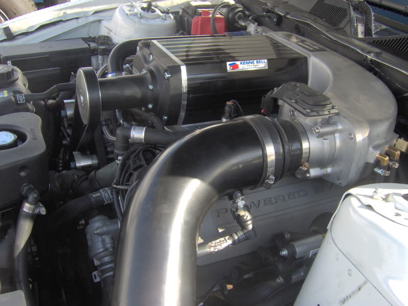

I was one of a few running the 2.8 KB blower on my 2011 5.0 in Socal
I also had a couple friends with both Vortech and Paxton blowers.
We never raced each other but we did mess around a little on cruises.
I loved the KB and they were happy with their choice of superchargers.
The KB was very streetable and my car was a daily driver with 3.73's
sure I could light up the tires into 4th gear if I got on it but there was no problem just driving normal on the street.
I had forged pistons and con rods and upgraded suspension,brakes etc
but stock fuel pump and 47# injectors that came with the KB kit.
My car was dyno tuned at ST Motorsports and made 580rwhp at around 9lbs
It may cost more upfront for the KB but I feel it's worth every penny.
The acceleration under boost was wicked and it just did not stop.
I sold my car last year and got something a little more tame lol
a Honda Fit with a whopping 117hp
I'm not on the Mustang forums much anymore but saw your thread and wanted to chime in.
You really can't go wrong with any of the current blowers for the 5.0 but the tune is the key.

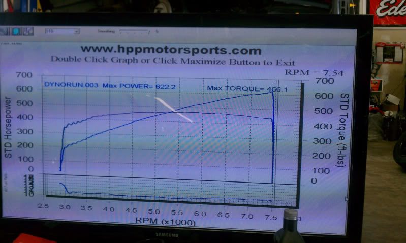

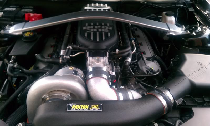

You can't go wrong with any supercharger choice IMO. I went with the Paxton though. I feel it's the best bang for the buck. I made 622rwhp and 466tq STD in 95 degree Texas heat. My mods are Boss intake, lethal o/r h pipe, ID1000 injectors, and Vortech BAP. The car is a blast to drive on the street. Drives like stock until you get on it, then hold on! The Paxton is pretty efficient, I'm showing about 7.5 lbs of boost through the stock air box. Good luck with your choice.

Very nice!

Is that a 2200? I want that kit so bad.

Yes it's the Paxton 2200SL. Get it, you won't regret it.
