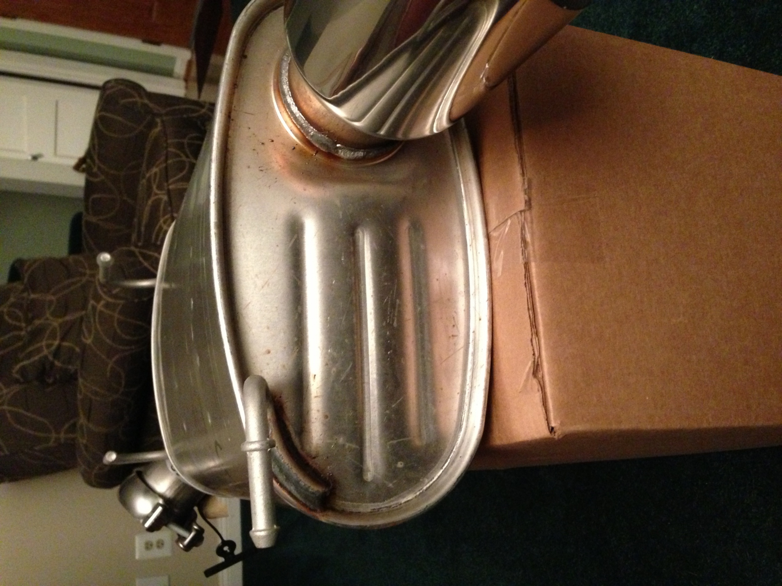

I just received my set! Took some steel wool to them and got rid of those weld burns. They look great! Install is tomorrow!
That was after you scrubbed them I take it lol They look better than mine. I only scrubbed with wet paper towels

Not sure what you mean by weld burns, bit the discoloration from welding looks awesome IMO. Shows the work better and it looks cool.

View the attachment [ATTACH]Am I the only freak show that scrubs his AB before installing?-image.jpg[/ATTACH]

To me that's unacceptable that Ford would try to sell that
Old Sep 6, 2013 | 09:03 PM
Wouldn't bother me in the least

Par for the course. That what our flex exhaust looks like. New.

I think this is normal for an OEM part, most OEM factory parts dont get the attention aftermarket parts do. As long as the tips are in good condition, I would not be worried about those little scratches.

You just mask off the pretty polished tips and spray everything else with flat black high temp paint. Modding 101 kids.

The stock mufflers look like they're made of stainless steel. If so, scrubbing with steel wool will cause them to rust! The wool disrupts the surface of the stainless and imbeds steel/iron particles which will rust and cause rusting of the base metal. You could use fine sandpaper or, better, a Scotch-Brite pad to clean them up. Just be sure the paper or pads were never previously used on steel or iron.
