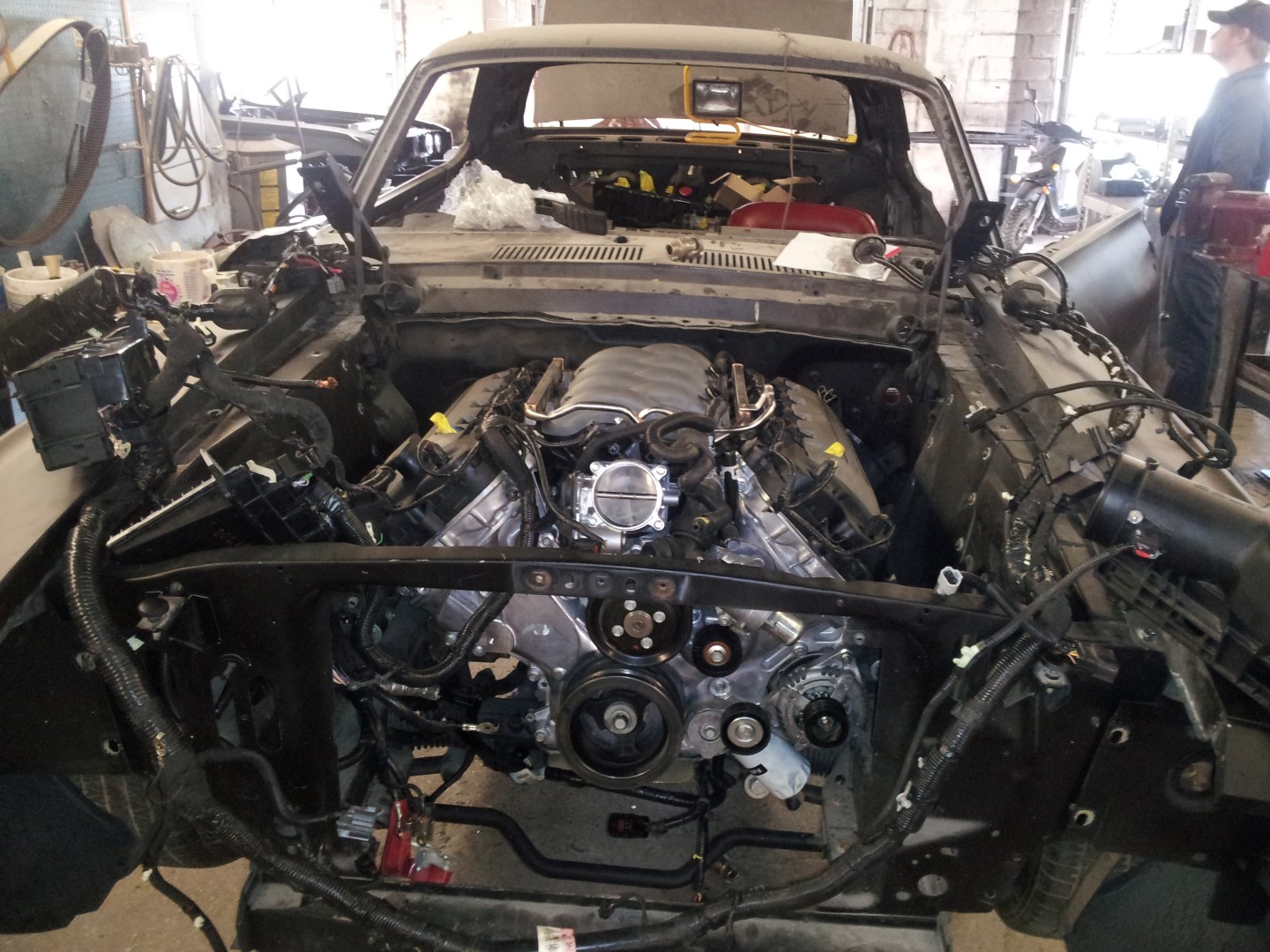

First pics attached, engine is in the car!Name:  AajlcRE.jpg
Size:  358.8 KB http://imgur.com/mW4Wgsi

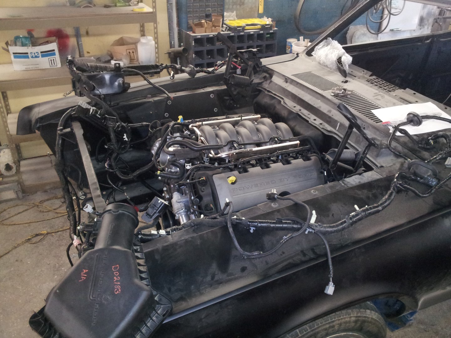

[QUOTE=southfanning;6712030]Thanks Brandon302, I'll check that out.
Size:  358.8 KB Name:  mW4Wgsi.jpg

It looks right at home in there

That's going to be a fun ride, with 600lbs less it going move right along.

Looks like it wouldn't have been possible to fit it in there if the stock shock towers had still been there.

Oh, no chance it would have fit. The shop tried it in stock 67 mustang just to see, they said it was nowhere close to fitting. I originally removed the shock towers to put in a 4.6L, and that 4.6 looks like a baby compared to the coyote. This thing is a beast!
