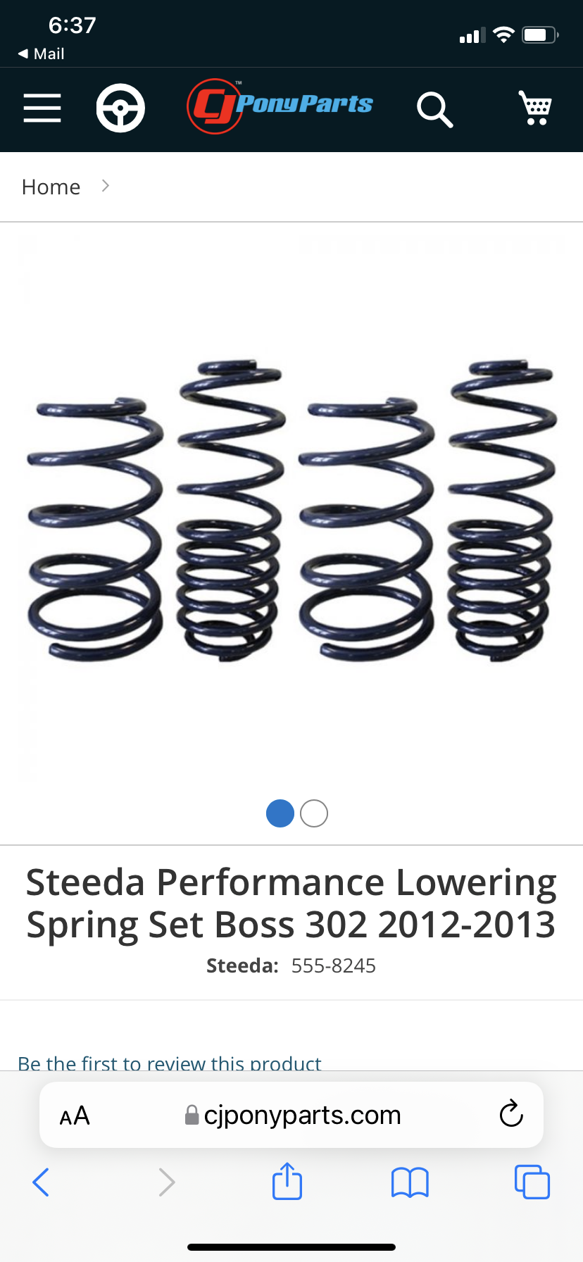

Are the Steeda performance lowering springs considered a progressive rate type spring or linear type spring
