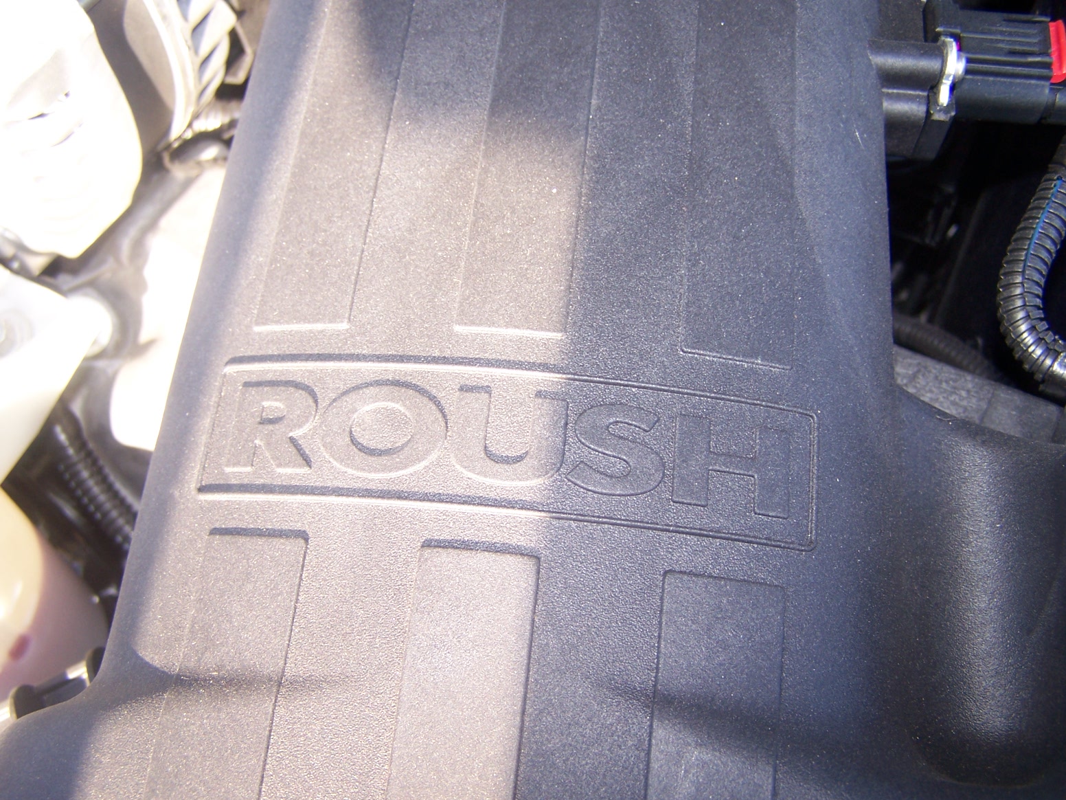

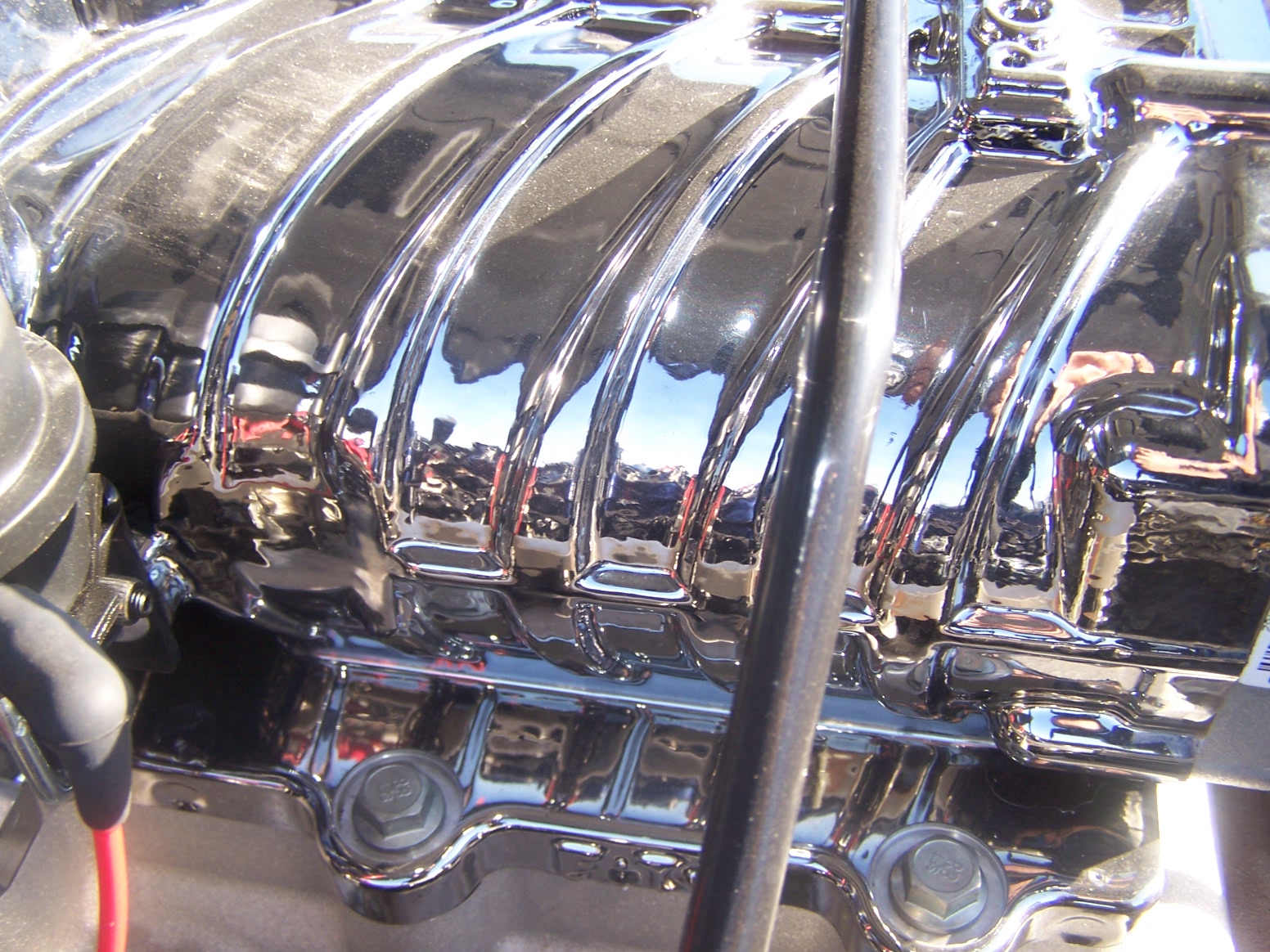

2010 Ford Mustang GT w/ what I believe is a M90 roots supercharger. As seen here http://www.packeywebbford.com/inventory/details.aspx?s=u&id=10T1522A&d=Ford&m=Mustang&y=20 10The gearing? No idea. The dealership doesn't know either. But I know that if I jack the rear end up and turn the rear tires and count how many times the driveshaft makes a full rotation after 1 full rotation of the rear tire that it will tell me. Those of you w/ 4.10's plus a supercharger I have no idea how you all hook up on the street but that's another topic.

-Can anyone tell me what type of blower this is? I assume roots? But I'm a newb w/ mustangs let alone going FI.

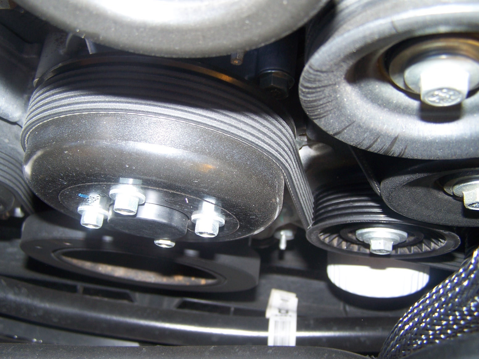

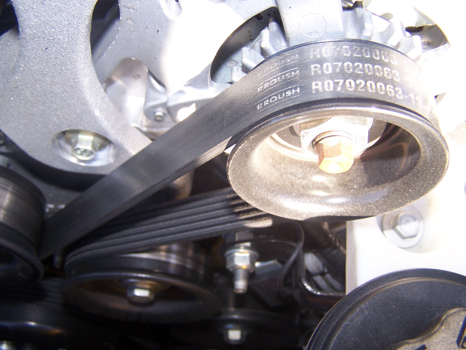

-Do you all have ABT's? (automatic belt tensioners) it keeps the belt from slipping. If not do you all get HD tensioners?
-Do you SC owners keep spare serp belt in the trunk in case your belt shreds while daily driving?
-What belt do you all use? Back when I owned RSX then 350s gator belts were highly praised by those whom were boosted.

You are correct, that is the Roush M90 supercharger which is roots style. I'm adding one of these to my 2010 around Christmas time as well. I used to have a 2006 Blaze Orange RSX-S, absolutely loved that car and dearly miss it.
The M90 is very proven kit and I can assure you that you won't need to worry too much about reliability issues and supporting your drive-train with the factory tune. If anything, you will want to upgrade your suspension and tires so you can put the power down.
I can't answer all of your questions but I will answer what I can. The M90 kit is intercooled. From what I have read the intercooler is a lot larger on the 2010 compared to the 05-09 kit. You won't need an upgraded intercooler or heat exchanger. The M90 is down talked by many since it doesn't have a huge ability to be upgraded to huge numbers. It uses older technology compared to the modern twin screw design found in Whipple, Saleen blowers etc. The M90 is very limited to how much power it can produce, however 430rwhp can be accomplished with an aftermarket tune and pulley upgrades and at that point it's pretty much maxed out. This will make the little M90 absolutely scream. This will of course void the powertrain warranty. A stock M90 runs around 5-6 psi, and if you get an aftermarket tune and pulley upgrade it will take it to around 8 psi. You won't be able to get 12psi out of the little M90 so don't even worry about that. 430rwhp is considered completely safe on stock internals as long as you have a good tune. If you want even a little more power you can do full exhaust, cams, and upgrade the fuel pumps, but other than that as I said it's maxed out. The M90 kit is perfect if you're not looking to get into the engine internals, like myself.

Thanks for the reply. I'm shocked that the roush M90 kit comes with everything one would need.
I really figured that an auto tensioner, colder spark plugs, fuel rails, upgraded fuel pump, ect... ect... would be needed to fully support this mod.
