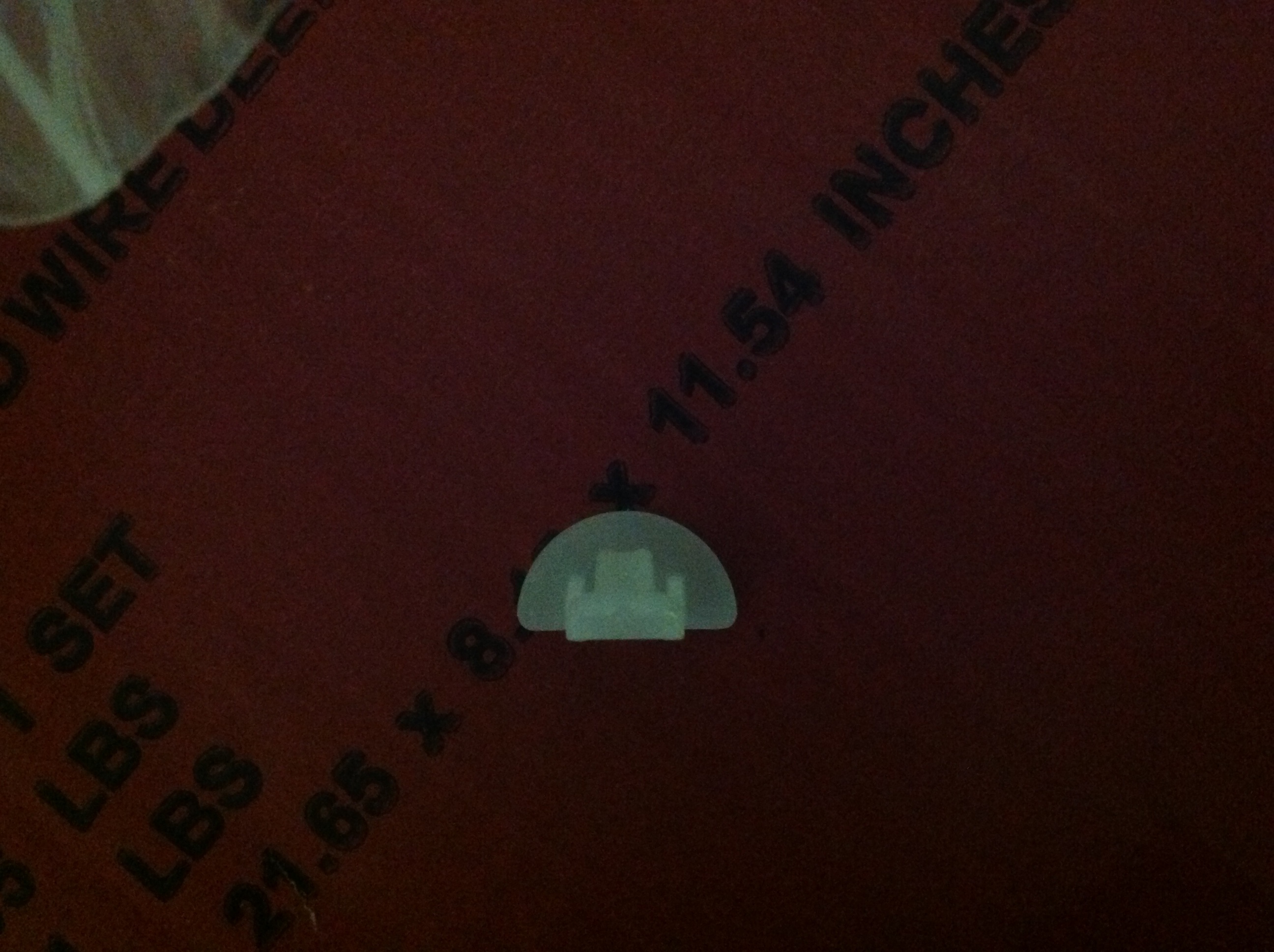

I crawled under my GT to check out the view, and it looks awful tight! Did you remove the mufflers before making your cuts? Also, the fasteners I speak of, nine to be exact, are white and half moon shaped. They hold the "tangs" on the valance in place so there is no shifting at all. I will send a pic of the fasteners.

The clips I speak of that came with the GT500 valance.

Yeah I figured you were talking about those. If u look at the stock bumper it has the same tangs that use the white clips. You can reuse them for the gt500 valance or use the ones on the gt500 valance your choice.
