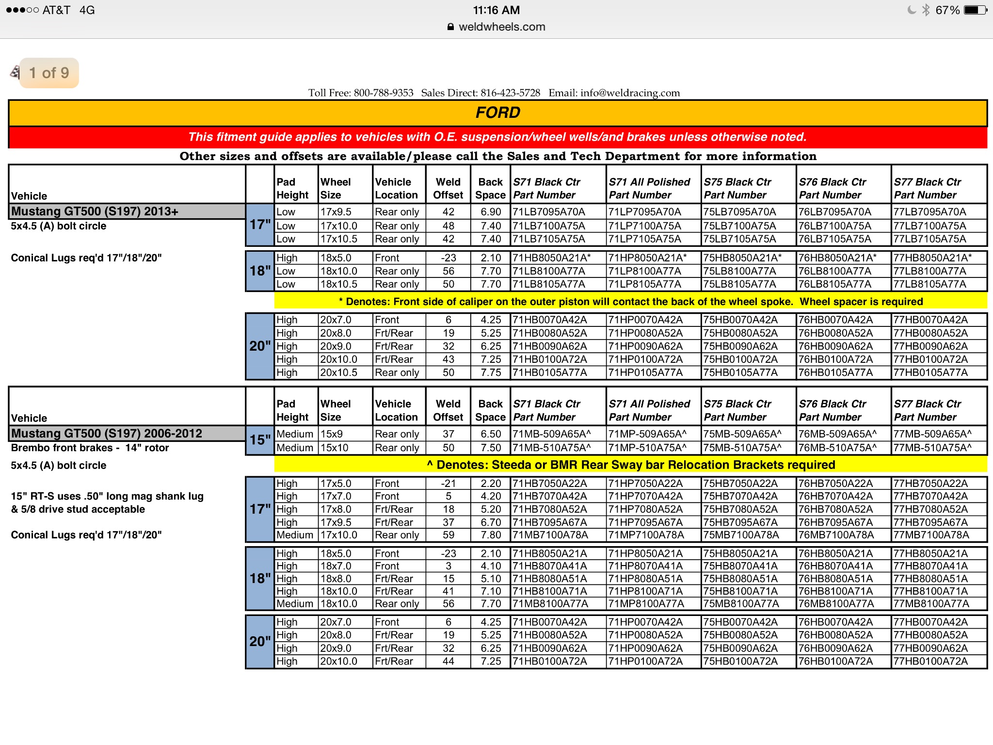

Sorry for poaching into the GT500 forum, but I am looking for a track day setup for my GT. I have the '13-14 GT500 brakes on my car with the 15" rotors/6 pot Brembo up front - same as the 13-14 GT500 OE.
Anyone running 18" wheels with DOT/competition tires? I am looking at the Enkei PF01 18" but not sure if it will clear the caliper. Anything else that will clear?
If I have to stick with 19" - any suggestions?
I'd prefer a square setup.
TIA !

Weld racing offers a wheel line that 17" fits over the rear 13.8 rotors according to their fitment chart. I was planning on buying the weld racing s77b in 17" by 10.5 for my 14 gt500. looks like they got 18" to fit the front.
Attached Thumbnails Track day wheels/tires for '13-14 GT500-image.jpg
