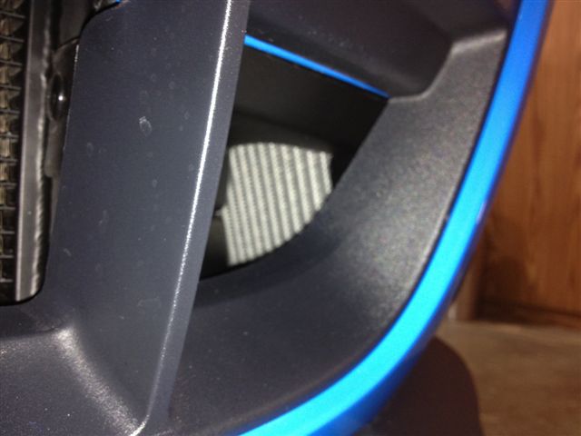

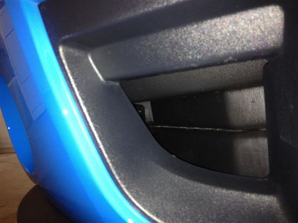

That's not necessarily true. If you have the Track Pak then there are transmission and differential coolers which are ducted to from the openings at either side of the lower grill area of the 2013 GT500. You can't necessarily get the air from the front of the car to the brakes via these openings.
It looks like you either remove the fog lights and duct through those openings, or cut/mold in new openings in the lower valance to get air to the front brakes.
I've emailed FRPP on a couple of occasions with questions about how to duct the brakes, but although I received an initial response, I've not heard from them again.
Here's a couple of photos of the openings and the radiators behind them.

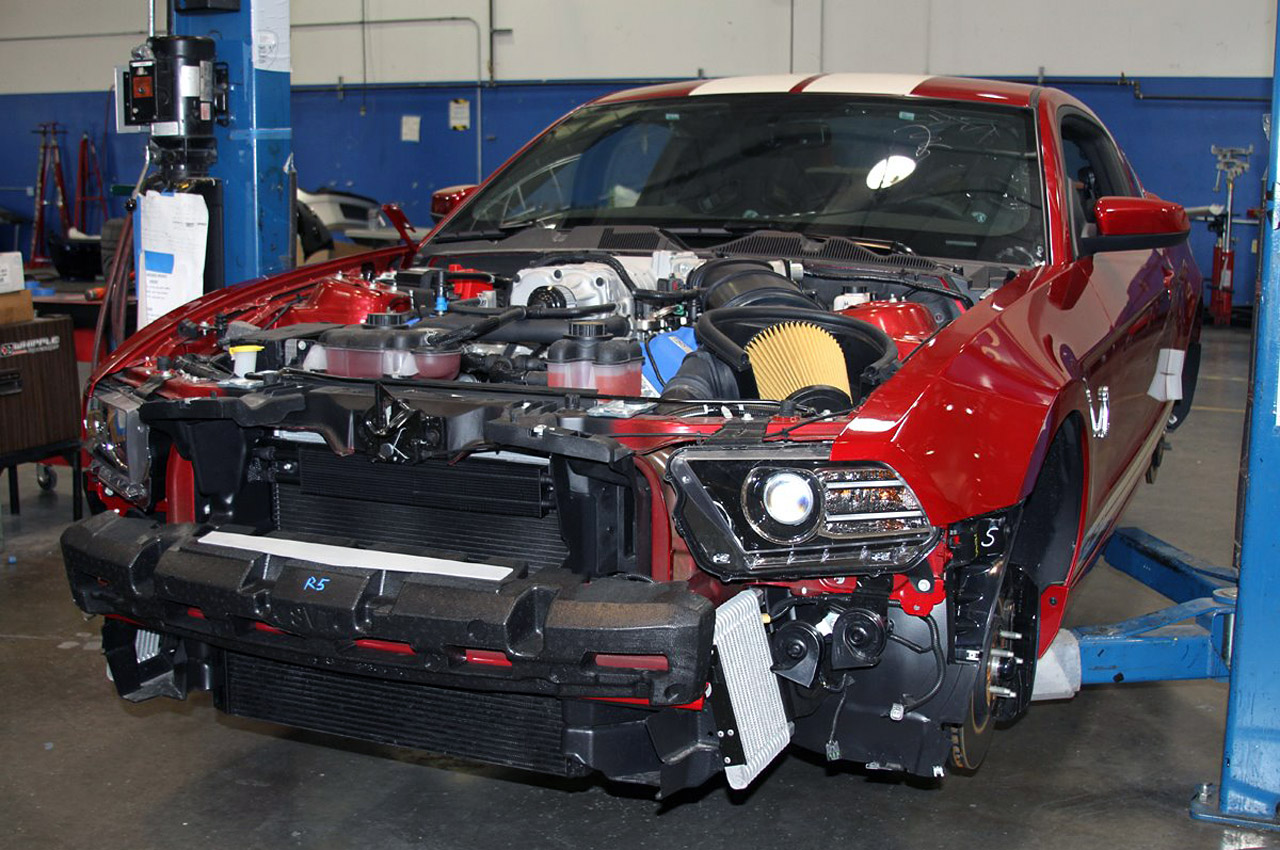

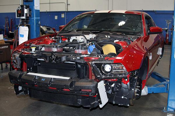

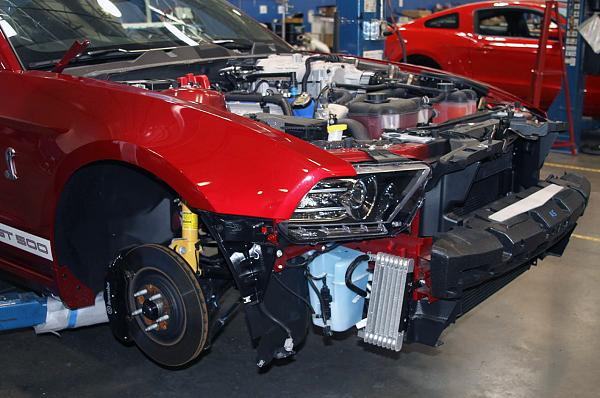

The transmission oil cooler goes across the radiator, the rear axle oil cooler is behind the passenger side opening in the lower grill and the engine oil cooler is behind the drivers side opening on the lower grill.

Great Photos without the Front Bumper
Mustangs Daily's piece on the building of the 2013 Shelby Super Snake has a couple of great photos which show what's behind the bumper, and the coolers that are fed by the ducts on either side of the lower grill opening.
Also, what may be in the way if you want to run brake ducting..........
