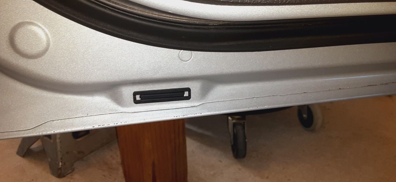

Originally Posted by metroplex
Pic.
It doesn't look like it can be easily removed. There is a clip for the forward drain and rear drain (rear drain shown in photo) of each door.
hi - the clips just pop right out. I asked at the ford service desk about them as it just did not make sense to plug the drain holes. They said to leave them in. After 3 years the bottom of all 4 doors are starting to rust.
The ford service adviser took pictures and send them to ford , he wanted them to make necessary repairs. Of course they refused at there were no holes. I took them trust me do not leave them there. I took them out and the water came out. I rubbed the
loos paint off, sprayed painted and waxed the door bottoms. I also spay Krown repellent once a month in the doors as a replellent. The doors have not gotton worse. Bottom line remove the clips
Has anyone else noticed black plastic doohickeys clipped into the drainage holes on the doors (at the very bottom towards the front and rear)?
Were these removed during PDI (are they still on your car)?
Should I remove them?
no they are there to stop the water from getting in the car you should remove them after a few good rain days to drain the water. if you remove the cover then water will come into the car and get the floor board wet just like mine are now. been looking for a set for my mustang but with no luck
