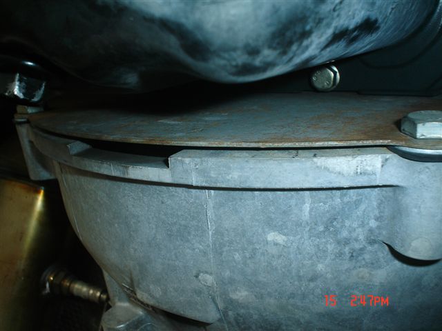

This one annoyed me for awhile. Really, really emabarassing.
I checked to see if the bell housing bolts were there and they are. But if you look up inside between the housing and the plate, there is an extremely tight clearance there. I'm not sure if its because of the tight clearance, but I'm pretty sure its just that plate resonating. The resonance is dependent on RPM and temperature.
So here's the fix... Just undo the two lower bolts that hold the plate to the bell housing. Put a small spacer (1-2 mm) in between and bolt back up.
It'll be fixed.

You are the man! Sheer genius! This fixed it for me I had that annoying, inexcusable 3000-3200RPM rattle, regardless of the engine temp, and it's completely gone now. I used a small metal washer, and a rubber washer as well. See the attached pic.

Went to the dealer yesterday, scheduled a fix for Monday, they actually fixed the issue on many vehicles (including Shelby's). Their explanation was that plate was actually vibrating and barely making contact with the flywheel, what they do is pull the trans, remove the plate and grind the flange down so contact is not possible). I feel fortunate that they've done quite a few vehicles already, cannot wait to get rid of the problem. Ford should step up and do something about this......

cost me $100 but I hope to have Ford Customer Service reimburse me as I am just outside Warranty...The fix: Found noise coming from trans bellhousing area, remove trans and inspect found flywheel rubbing on inspection plate, removed, replaced and modified inspection plate, reinstall trans and bleed air from hyd clutch, re-road tes OK..... ....man, my driving experience is 100X more pleasurable.............
