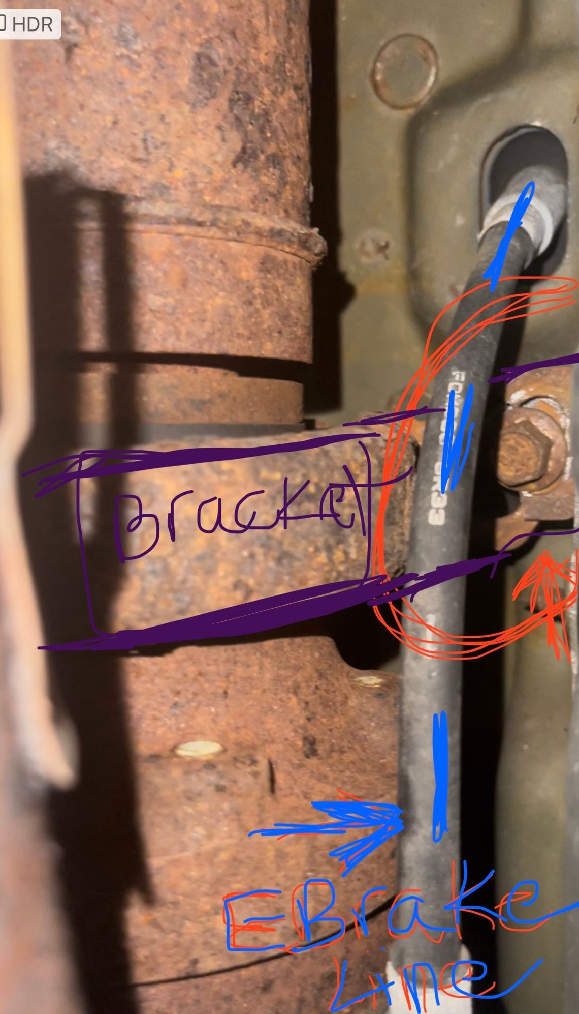

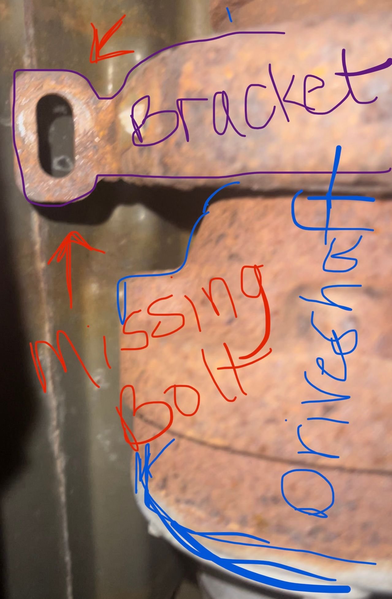

Hello everyone and thanks for reading and giving me any helpful info.
This is for a 2007 mustang GT 5speed manual 4.6L v8 with 90k miles.
so long story short. I was driving home from work and I hit a really bad pothole on the expressway. It sounded like something really loud hit under my car. When I got off my exit it sounded like and felt like there was a basketball dribbling under my ebrake lever. And when I would take off and drive it would stop, until I hit brakes or slowed down and again this obnoxious sound by my ebrake lever returned. After getting home and jacking car up, I was able to find the problem. The driveshaft bracket that holds the driveshaft up is missing a bolt on one side and is dangling and on other side it looks to be messed up longer and it’s bolt is there but the bracket is bent and broken on both sides of that bolt that is suppose to hold it secure to the car. I will post pictures to show but it was very difficult to get pics and probably even more difficult for you all to understand what I’m meaning. My question is…how can I just buy and replace that bracket and bolt. I can only find the safety loop system for the driveshaft, which is not the same but as far as I know it can be used along with this broken bracket… I have searched the internet high and low and am unable to find just that part! Please anyone that can help I will be forever thankful for!! Thanks in advance and for anyone who suffered through this reading. : /
2007 mustang gt. Help me. Broken bracket on driveshaft. And missing bolt!!

Ok, Looking At the Driveshaft From What I Can See and You Say You Hit a Pothole. It Is Possible You Simply Broke the Center carrier Bearing Retainer and One Of the Bolts. If and I Mean If the Carrier Bearing is Good You May get Away with Drilling Out and Extracting Broken Bolt.
Finding a Used Bracket & Attaching Bolts And Reinstalling I don't Know If The Repair Can Be Done With Driveshaft Still Installed or Not. So If Everything is Ok Less Bracket & Bolts This Would be The Cheapest Way to go.
Update
Looking at the Pics Of the Strap is Does Not Look Very Promising I think is a 2 Piece That is Spot Welded Together. Understandable as if It came Off Results Would Not Be Good! So Now Looks More Complicated Still Looking at Options.
Btw, Great Pics and Explanation and Also Including enough Information to Figure Out. Believe Me We Get Minimal Info Many Times When Folks are Looking For Help. Kudo's to You.
Ok, So Local Driveshaft Shop or Wrecking Yard May Have What you need. Also with So many Going the One Piece Route Maybe Somebody Out there Has Some Parts Laying Around! Hint Hint!

I believe these are the Bolts.
Shows to be 10x30mm. Since they Would Charge you Shipping I Would
Go To Local Ford Dealer and Ask For Driveshaft Carrier Bolts.
And Carrier Spacer. They Will Likely Sell you a Pkg of 4 If they Do Not Stock them!
You At Least Need 2 Bolts & 1 Spacer
Ford -W506434-S439
Bolt
Ford -W710432-S300
Spacer
https://www.fordpartsgiant.com/parts...xle_drive,,HB1
Spacer
https://www.fordpartsgiant.com/parts...xle_drive,,HW1
You Need HB1 & HW1 As Shown Here.
https://parts.ford.com/shop/en/us/ha...300759-1?pdp=y

I’m gonna follow up with everything you have suggested here and one question is the spacer what I have been calling the bracket?
Old Sep 26, 2022 | 09:16 PM
05stangkc's Avatar
Joined: November 27, 2004
Posts: 12,596
Likes: 4,347
From: Visalia Ca.
They Go Between the Bracket and the Floor. Look in the Ford PDF I posted in Post 6
Basically a Thick Washer. It's Got to Be Gone.
Watch & Read Install Info I Posted and You Will Be an Expert in no Time!
I learned a Lot Myself Today! Take Care of those Boys!

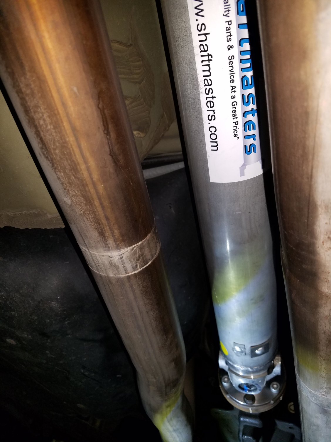

I tossed mine in the crapper and got a 1 piece Aluminum one. Installed easily and it has worked great! The only thing I didn't like was the "hex" pattern bolts going to the differential - they were very hard to torque. Bonus in the included new Spicer U-joints.
3.5" Mustang Aluminum Driveshafts for Transmission or Rear Axle swap Applications (shaftmasters.com)
Installed December 2017.
3.5" Aluminum Driveshaft FMS0510GT35D-1350 1 649.99
Ford Mustang 2005-2010 V8
GT Direct Bolt-In
Subtotal 649.99
Shipping 0.00
Tax 0.00
Total 649.99
