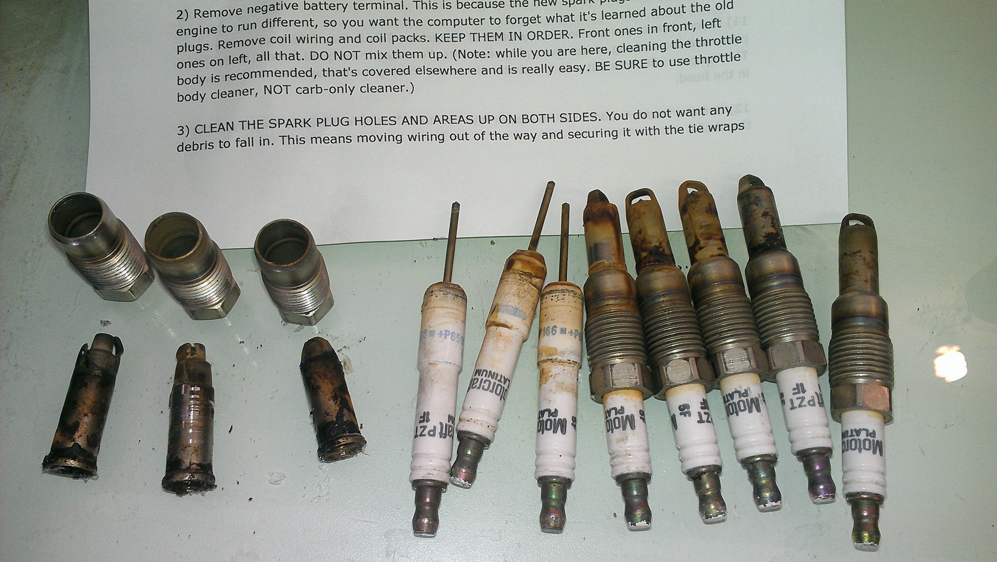

Broke 5 out of 8, but Lisle tool worked great. I let let soak over night and the first three came out, so I though I had it licked. Then the rest broke, but got everything out withe removal tool. Glad it's done.

Glad the lisle tool worked out for you and just know that after you apply nickel anti-seize on your new plugs, they won't break on you the next time around

Yes ! Your 100% correct.. From 2005-early 2008 Ford used 16mm 2 piece designed plugs and the reason why they're so characteristic to breakage is due from carbon build up upon the electrode portion of the plug which would cause it to seize up inside the head..
All Mustangs and F-150 trucks with 4.6 3 valve V8's had the 2 piece 16mm design plugs.. It wasn't until the later job 2 2008MY models that got the new revised heads along with the re-designed 12mm one piece spark plugs..

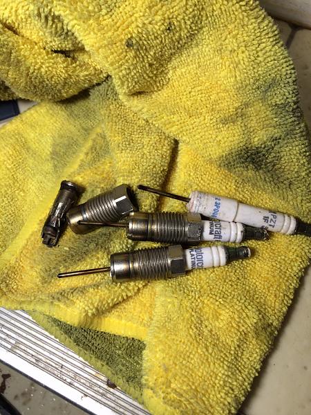

Awesome OP! I hated doing my plugs last year, broke 3 of them but the Lisle tool worked great! Stealership wanted $800 to do them. Hell with that! Did them myself, just took my time. 117k on the plugs too!

I went right back with the original crappy Ford OEM plugs... I read all the horror stories about poor Champion quality control and other issues, and I didn't want to deal with it.
These were my plugs when I got them out!
Don't forget the nickel anti seize compound!
