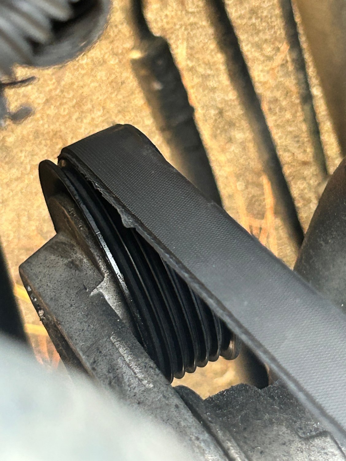

Hello i listed before on here, but im having the same problems. My belt and balancer is constantly popping off. My car loses power then it just falls off …. after a month of repairs. my belt and balancer are new , someone told me i might need a tensioner pulley, i will post a pic of the pulley rattling while the engine is on. i have no idea what repairs need done now so any help would be greatly appreciated.
this is a pic of the pulley it rattles and the belt was barely on there after repairs

Well It's Ripping One Tooth off The Belt Right Out Of The Gate. Need To See Vid of It Running and All Components Belt Rides On. Could Be Wrong Tensioner But I Can't Understand Crank Pulley Popping Off. Lets See Pics of Old Parts If You Have Them. Everything Simply Needs To Be in a Straight Line as Far as The Belt is Concerned. Could Have a Bent Crank or The Crank Has Been Worn At The End of The Snout. More Pics & Info The Better.

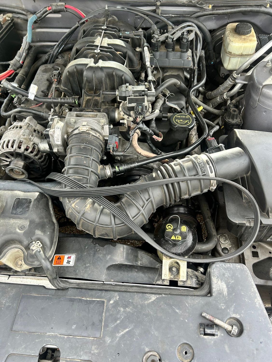

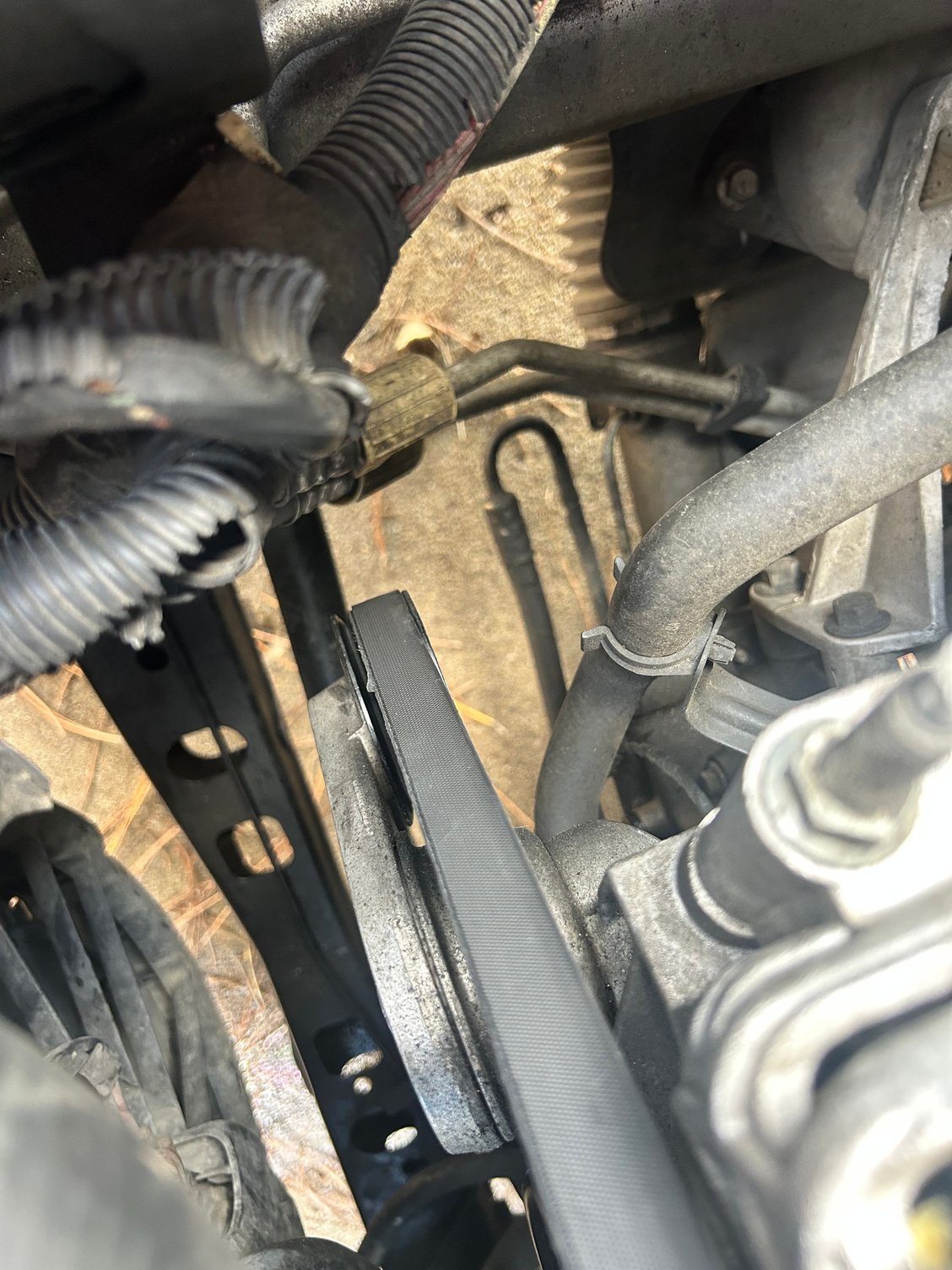

Hello, so once again my belt and balancer popped off after losing power and trying to start car. this is the 4thtime now since august 28th….. i saw my tensioner moving and belt barely hanging on there
belt barely hanging on the tensioner after repairs were done. tensioner shakes at the top and doesn’t look stable. it doesn’t move at all now that the belt is off..
car died at red light, battery light comes on, belt and balancer is completely off…..
after repairs. i was told either my balancer wasn’t mounted correctly or not enough screws to hold it in place or i could need a new tensioner. i have no idea, all i know is when driving you hear rattling under the hood, the car didn’t accelerate or drive properly , and it would eventually lose power while driving or coming to a stop. the red battery light comes on and if you try to crank vehicle then the balancer and belt pops off……. please help i spent all of september getting it fixed just for the same thing to keep happening.

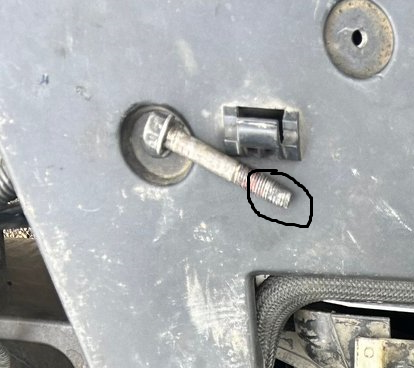

Is This The Harmonic Balancer Bolt?????? If So It is Not Correct.
The Threads are Stripped and May Be Due To Simply Wrong Bolt, Threads Were Stripped By Previous Work. A Piece Of Original Bolt From First Replacement Could Be Broke Off in Snout as Well. This Would Keep Bolt From Seating All The Way In.
This Is What Correct Bolt Should Look Like and They are a one Time Use{All Thread Special Bolt}. The {Shouldered Bolt} Pictured May Not Seat Correctly Which Would Cause Damper To Come Off. Hopefully The Threads in The Crankshaft Can Be Smoothed Out Enough To Get a Good Bite.
Now if This Is Some Other Random Bolt Whatever it Screws Into Will Need Some Attention to Bite.

It's also possible that whoever installed the balancer did a very poor installation job and very well could have stripped out some of the bolt threads during the installation process, but that's just a guess on my part...
