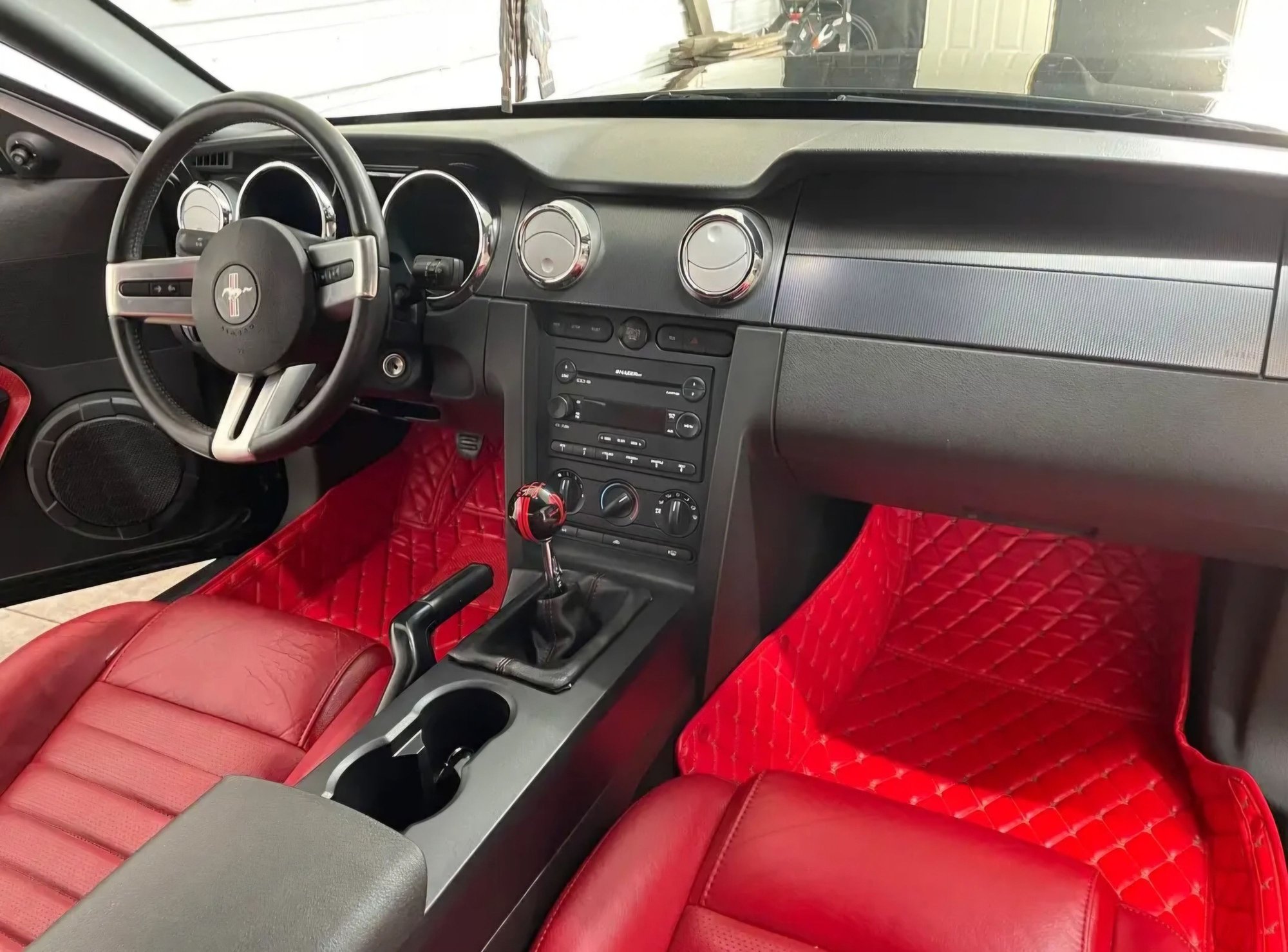

It does have a Hurst already in it. I hope it's that simple... this is the first manual I have ever owned. I am mechanically inclined but I have never in my life messed with a manual transmission although I can drive them just fine

Here are The Trans Removal Instructions. Glean For Shifter Layout. Also See Hurst Instructions!
I Have Also Included Console Removal Pdf If Needed!
The Shifter Mechanism Just Coming Loose Will Reek Havoc as Well See if Everything Feels Tight From Underside!
Removing The **** & Boot & Wiggling Things May Show Something Loose or Worn. It's an Easy Start!

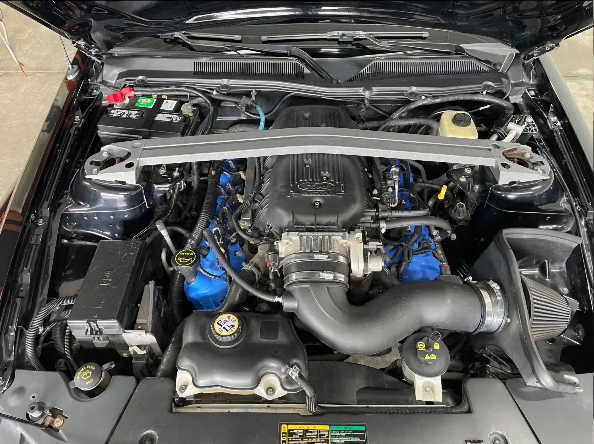

Thank you... I'm hoping it's something simple. There's no reason why it was shifting fine when I parked the car to go into the store and the gears are gone when I left the parking lot. Unless of course something was just that loose and fell off within that time frame.
The car already needs a tune as the engine is cammed, Ford Racing intake, Cold Air Intake, and someone put 4.10s where the 3.55s should be. I bought it this way. I already planned on taking those out because I'm not a fan of the 410 gears. I like to drive the car but I'm not a racer and driving at 70 miles an hour with the engine revving at 2700 RPMs is not fun.

You Are Welcome!
Yes, Some Busy Hands Have Been in There!
If At All Possible Contact Original Owner and See if Some Kind of Tune is In It And Anything & Everything About Car Mods & Service!
You Have a Task For Sure!

The guy who built it passed away. I bought it from a consignment seller as the builders son was not a car guy. It came with a Bama SCT X4 tuner thing. Looks like 2 tunes are programmed into it (87 performance and 93 race), but i would rather a "pro" retune it once i get the correct height tires on the rear and the 3.55 gears put back in.
