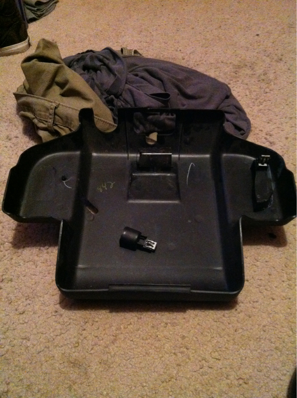

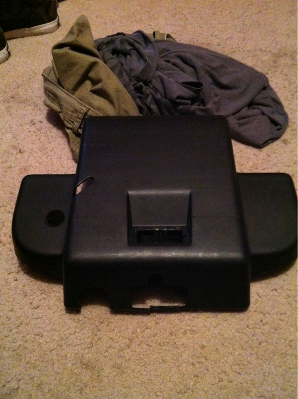

are these only available through ford?
Old Aug 31, 2012 | 08:53 PM
Agent MOO's Avatar
Joined: October 14, 2004
Posts: 508

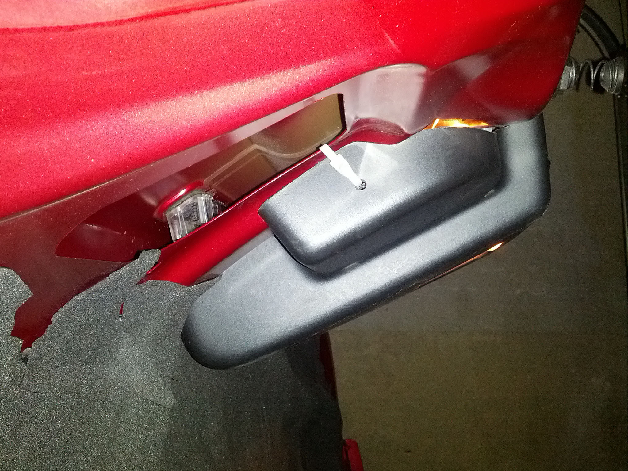

Are you talking about the plastic cover with the interior light thingy? That broke off in mine a while ago. I drilled a hole in each side of it and used cable ties to hold it in. It's been rock solid since
Old Aug 31, 2012 | 08:59 PM
SilverSkoundrel's Avatar
Joined: November 6, 2011
Yes this piece. I might try that though!!

Here's the spot where I did it on each side
