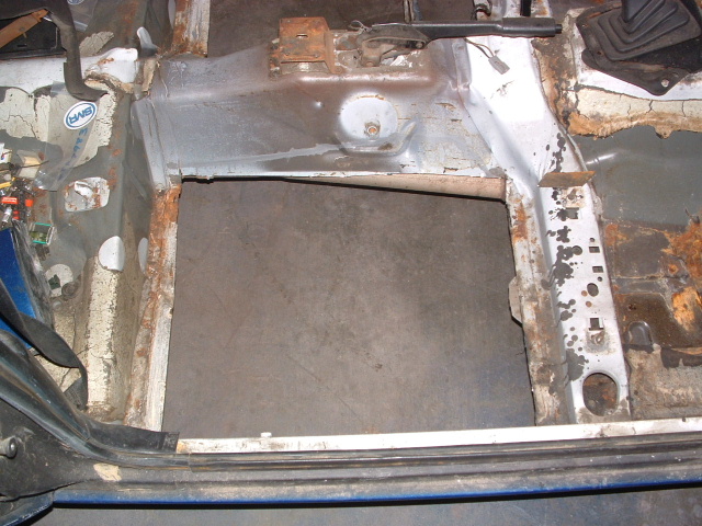

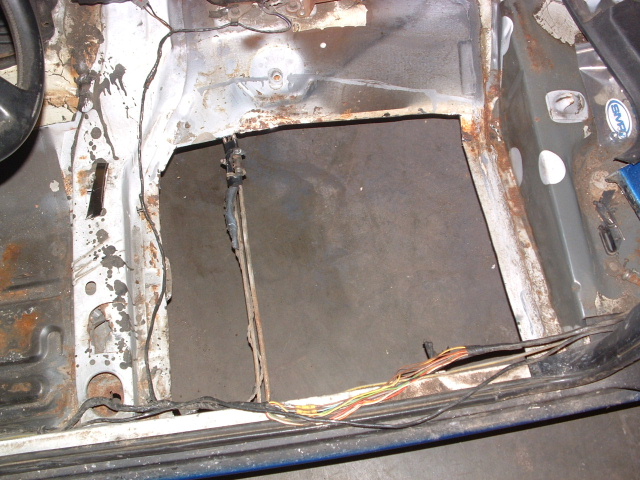

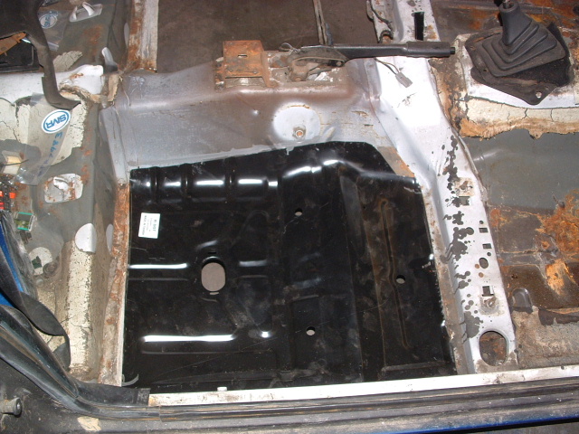

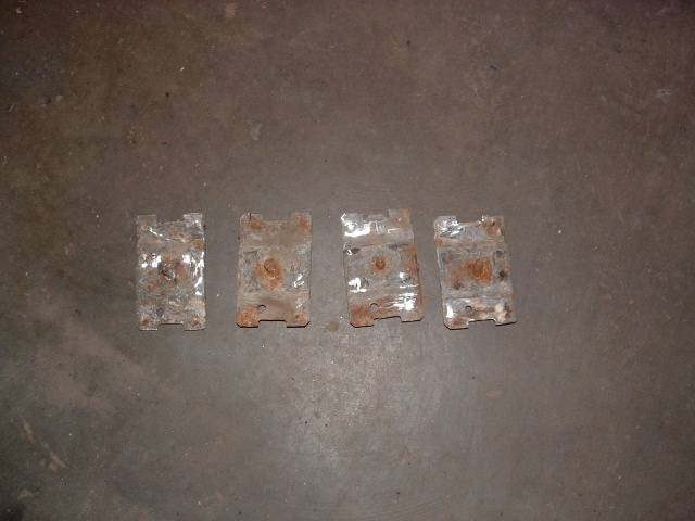

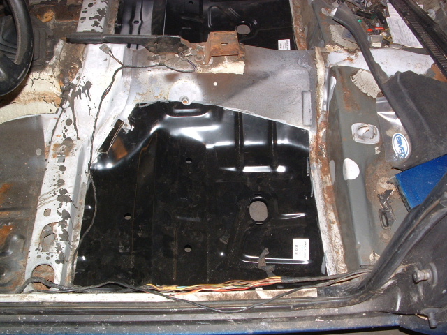

I got my new floor pans from CJ Pony parts yesterday. I decided to only replace the rear section as that was the only bad section. I cut the old floors out, then cut the new pans to fit. I wasn't too thrilled to see that they were made in Taiwan, and the fit wasn't real good. I also had to remove the seat mounting plates from the old floors, since the new ones didn't have them.

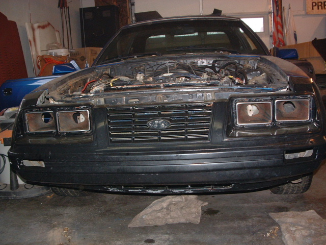

Here's a few pics of the progress so far. Last pic is a test fit of the "new" front end.

Is that the front end off of the crusher at KennyG's?
No, just one we found laying on a car roof.

Never know what you will find up there. I would bet money on a Sunbeam carcass, a Ranchero and Falcon conv.
