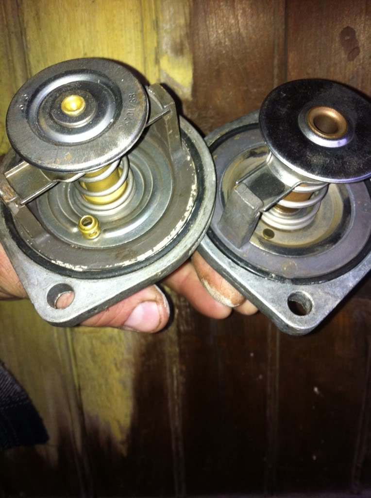

Be advised these days many FORD Stat's have a Built in Bleeder Valve in the Stat. If the Aftermarket Stat does not they can trap Air & Cause Issues. It's a little fixture on the Flange with a small BB in it. I'm not sure if the Stangs have one and I don't have one handy but be advised.
I know back in the day on the old 2.8L Stang II's I would always drill a pencil lead size hole on the flange so they would bleed. Darn Stat would not open without it in many cases. Good trick for any stat that does not have a Bleeder. It won't hurt. The hole has to be free of any mounting flanges though.
Pic is of PowerStroke Stat. Example of Check Valve Bleeder FORD vs Aftermarket Pin Style Bleeder.
KC
KC
KC
My motorcraft thermostat I just replaced didn't have 1, but my autozone brand does.
That's Odd But you Learn Something New Everyday. It's possible the PRODUCTION one Does not have one But the SERVICE one Does.Or they just may not on that model. I have seen differences in parts like that from time to time. I prefer the Bleeder Style. But what Year Stang are you Talking about?? Your Sig says 67?? That would be a factor as well.
KC

Bradley surprised me today. When I came home from work he showed me the thermostat that came out of my car. It was really corroded and rusted. My car now has a new stock thermostat in it. Decided not to go with a 180 due to the possibiity of throwing a code. We just want to completely solve the problem right now. Hopefully this will work.
