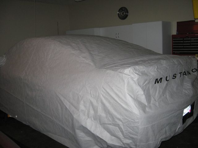

I was wondering, if a person was to dyno-tune there Bullitt , would that shorten its engine life?
I know that if our cars break down, it is considered an opportunity to mod our cars.
I love the dependability of the car.
The problem is that I love power and the noise of the Bullitt , I always want MORE.
Now that my car is in storage and I haven't seen it for 2 months now, and I won't take it out for another 4 months, that is all I think about.
Modding my Bullitt isn't as important as just driving it .
Sorry for babbling on.
That is what old guy's do

do you start the car once a week or two while its in storage? I sure hope so, or that is going to kill its lifespan more than a dyno tune ever would

Nope
6 months of being under a cover

I would seriously recommend running it.

I know a lot of people that don't start there stangs 6 months with out having any issues?

did you put any fuel stabilizer in it before you stored it? That would also probably be helpful.
and you definitely want to run it every now and then. Even when I wasn't driving my Mustang II often bec I just wasn't around, every time I came home I ran it for a few minutes to prevent it from gumming up

you definitely need to run it at least every month if not every week or two
Moving parts need to be moved
when they do not move, they start doing bad things...

.....and running the engine for a few minutes every week or two can be worse than not running it at all because moisture and contaminants can be introduced into the oil that would normally be burned off if the car is completely brought up to temperature and driven for a few miles. I store my Bullitt every winter and at most start it up once in 3-4 months (insurance is pulled except for comp, so no driving it), and my '08 will be driven at most once or twice a month from November through February, and that is only of the roads are salt and snow free, it isn't raining, and it is above 30 degrees. No problems with doing it this way for years on a variety of cars. I personally wouldn't put any of my cars in storage on jack stands though, but that is something of a matter of personal preference, I just wouldn't want my suspension at full droop for 4-6 months.
