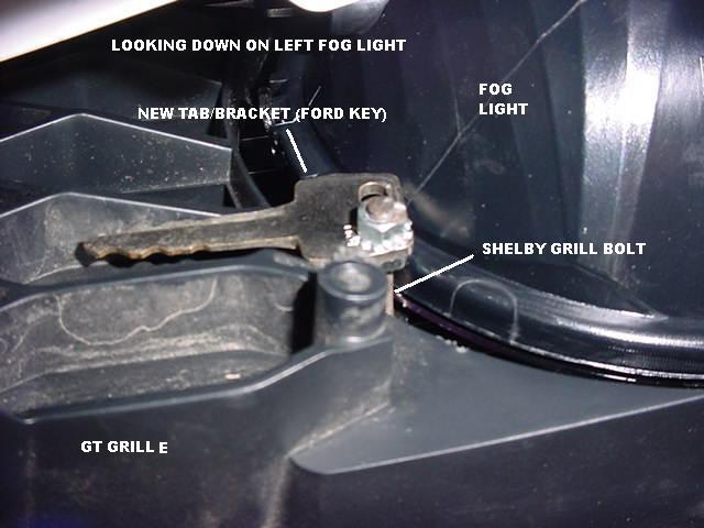

More pictures & procedure
I did not take pictures of the work; however, I just took and attached “behind the grill picturesâ€.
<o> </o>
Here’s the procedure:
-I purchased a set of GT fog lights with brackets from CJ Pony
-Take off the grilles; the <st1:city w:st="on"><st1lace w:st="on">Shelby</st1lace></st1:city> grille is attached to the GT grille
-The depth of the lights with their bracket is too great to be placed behind the grille
-Remove the fog light brackets; the lights will
fit behind the grille
-Remove the two grille brackets which secures the <st1:city w:st="on"><st1lace w:st="on">Shelby</st1lace></st1:city> grille to the GT grille, because they interfere with the fog light “holesâ€
-Replacement grille brackets are needed; I used old Ford keys (yes old Ford keys … hey, got to improvise). Two keys per side make great tab/brackets to securely affix the Shelby and GT grilles together. Plus they serve as brackets to hold the fog light in place.
-Place fog light into position
-Along with the two keys, a 1†x 5†metal strip serves as the third and last bracket to hold the light in place; attach to existing GT grille fog light socket and swivel to lock fog light into position
-Plug the existing fog light wire/socket into the fog light bulb socket; this allows the fog lights to be controlled by the light switch in the dash
-Replace the grill
-Place a 15 amp fuse is #58 slot in the fuse box in the engine compartment; Shelby America had removed the fuse and placed it in a spare slot; just reuse it
-Turn lights on; remember the engine must be running
Attached Thumbnails Add Fog Lights to my Shelby GT-key-bracket.jpg   Add Fog Lights to my Shelby GT-metal-strip-bracket.jpg   Add Fog Lights to my Shelby GT-grille-brackets.jpg
