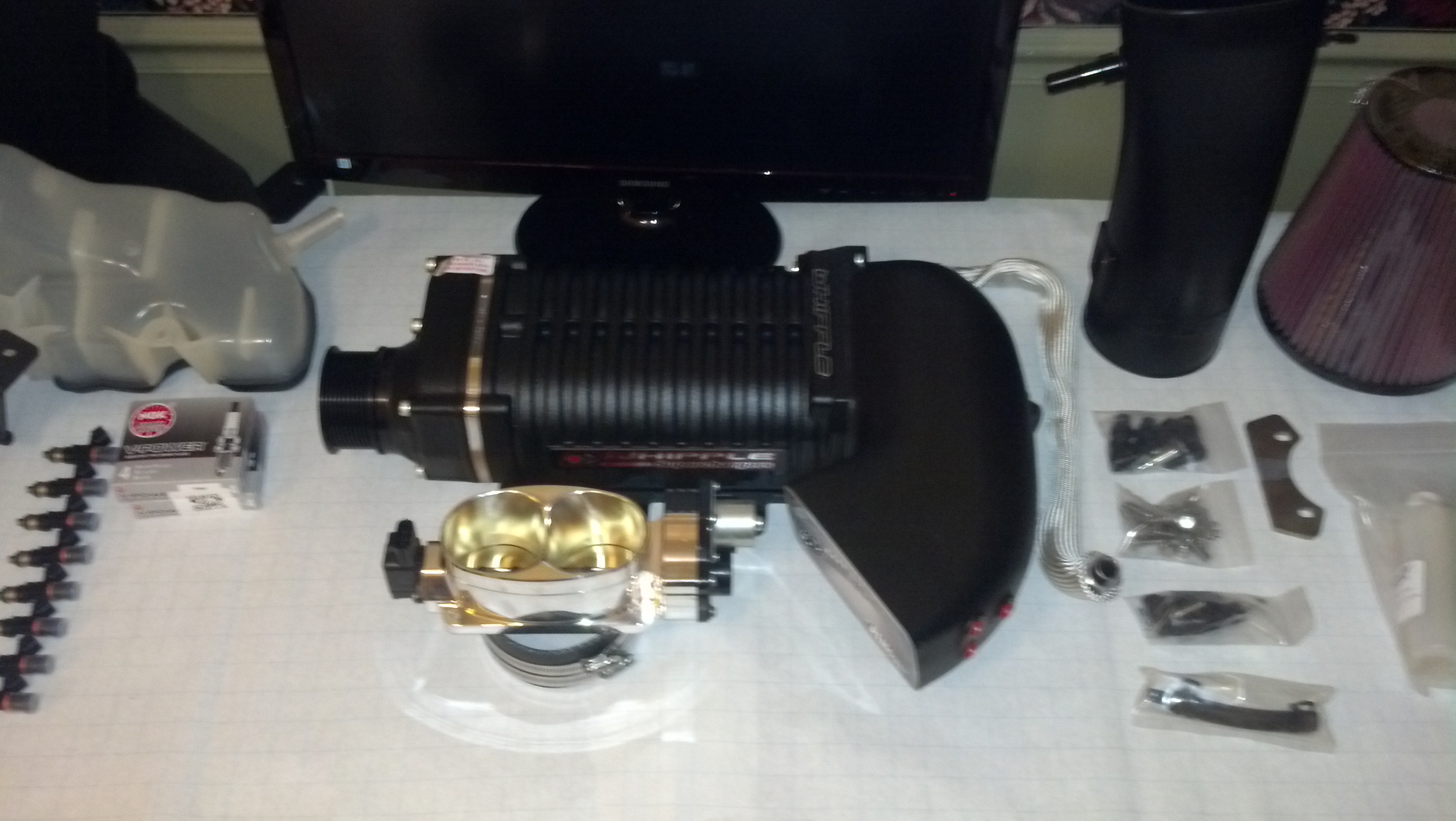

Well almost there, got the 2.9 Whipple in with a minor change. Lethal said they were getting a metric crap ton of complaints with the mono-blade so the kit has been updated with the 65mm dual-blade t-body. Lund Racing said the same thing, go with the 65mm dual blade which flows around 1500 cfm and that would make it good for about 900hp (1518 cfm / 1.67 cfm per hp) which "should" be enough to get the car to 700 rwhp guestimating the parasitic loss due to the blower and drivetrain provided it actually takes around 100hp to make 18 pounds of boost and the drivetrain holds steady at 15% (as that seems to be a reliable figure for the TR6060, stock final gear and stock driveshaft) and while Lethal says with 72 lbs/hr injectors fuel mods aren't required Lund Racing recommended a BAP as well including a better H/E and 170 t-stat before I bolt on the blower.
Also if anybody knows somebody looking for a take off blower, I'll be boxing up the ported M122 HEaton, 2.59 Overdrive Pulley, Stock Throttle Body, Stock Injectors, Stock Heat Exchanger, FRPP 113mm MAF Housing, and FRPP CAI housing once I'm done and asking 500.00 bucks for the whole deal (well plus shipping). I've posted elsewhere with the dyno run but in cool air this was good for almost 550 rwhp (3" dynomax cat back race bullet exhaust) on my car with a VMP canned tune.
