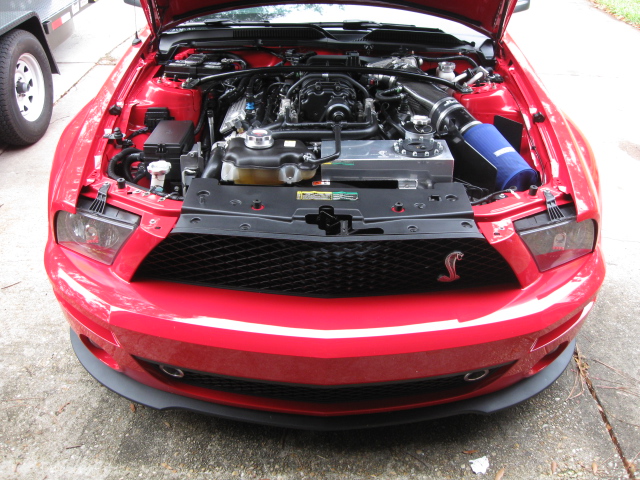

First I would like to thank Ron Willim at Blue Collar Performance for letting me test fit these brand new hoses. I wish I would have been able to get it done in time for SEMA 2009.
Here are the Samco GT500 hoses Samco GT500 Silicone Hose Kits[/url]

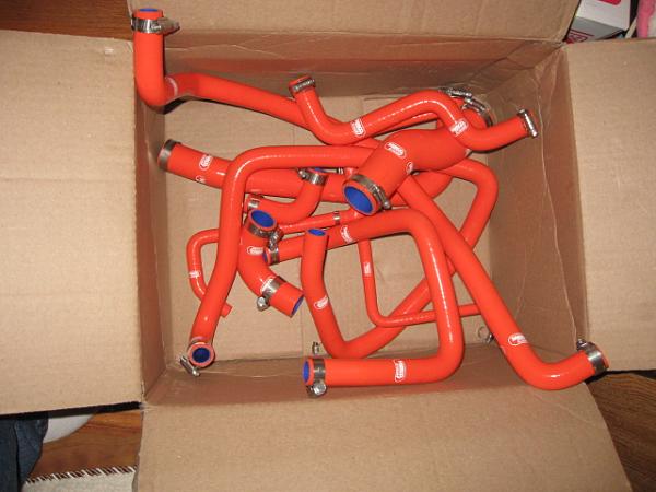

After review this is a complete under hood replacement set of hoses it also includes the return line for the Power Steering Reservoir, All Coolant lines, and all the Heat Exchanger lines.
First off look at all your lines and go slowly to make sure you use the correct line and end for each hose. The hoses are not marked but do fit just like the factory hose they replace. Then go underneath the radiator and drain the coolant.
Here are most of the hoses except what I call the Octopus, that is the lower hose on the GT-500.

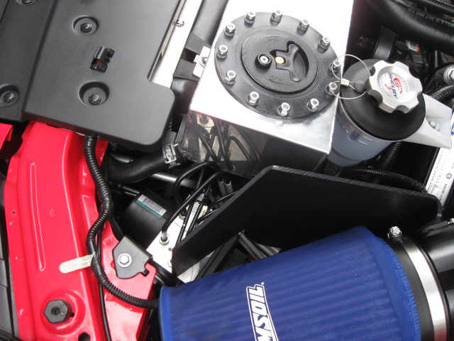

Again inspect all your stock lines and clamp locations before getting to far into it.

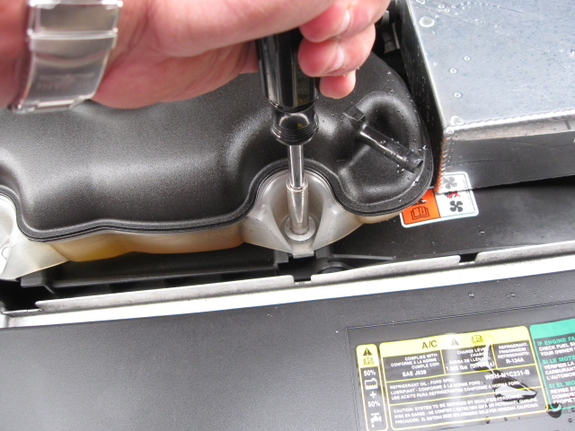

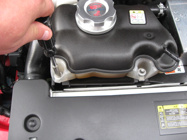

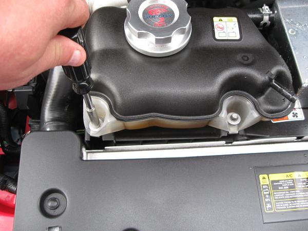

Next begin by removing the upper over flow return line it looks like a Y and then remove the 2 coolant tanks.
These tanks use a 8mm socket to remove the bolts.

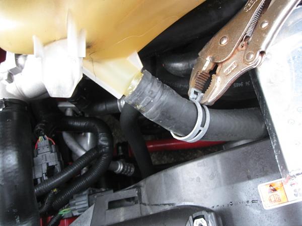

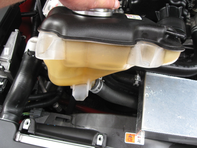

Raise the tank and then remove the clamp and hose. Be careful if you haven't drained the system then coolant is going to spill out.
I recommend using a ViceGrip to remove these clamps.

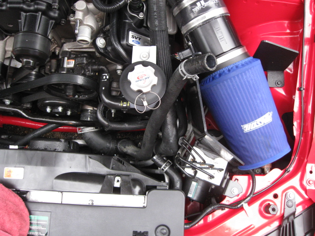

You should now have a good view of the lower hose system. There are 6 connections that make up this hose and it is all connected.
You will have 2 lines that go to the Coolant tank and the outlet on the left side. In the Middle you will see the main line going in the front of the engine. You will also have to get under the car to gain access to the hose that runs under the center of the engine and also to be able to remove the main lower hose off the radiator. There is one last connection just under the power steering reservoir.

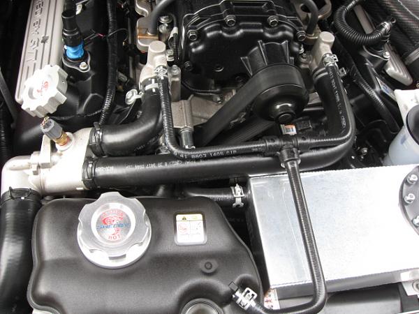

Here is the bulk of the new lower installed

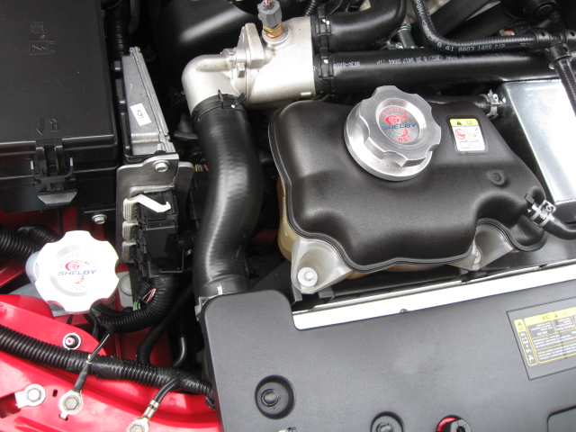

Now just match up the rest of your uppers and replace them as you remove the old hose.
And that concludes the main coolant lines.
