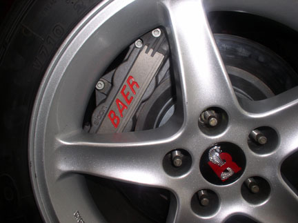

This a picture of my track wheels on the car; there is much more clearance in diameter than stock 17" and also in offset; so there is a possibility I could keep my 17" for the track
Here is a pic of the 5zigen (yeah, there is rust but I live in Canada !) Think they would clear the Brembos ????

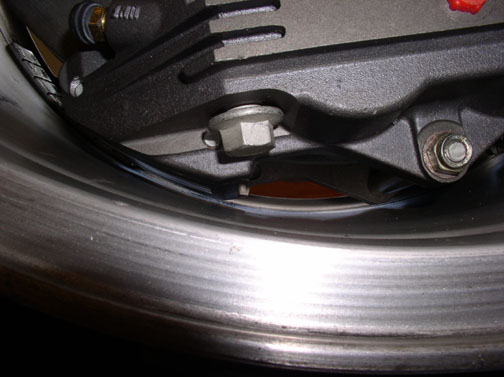

2007-2009 Shelby 14" rotors with Alcon 4 piston brake calipers:
Yes, it's tight but it does fit and doesn't interfer......

Don't bother--they won't fit judging by your pic. I just installed the GT500 kit on my car a couple weeks ago. I have American Muscle GT500 18's, could be a "cheap" route for you to get some wheels that clear.

Sorry, let me try it again.
Personally I'd go with the 18" 07-09 Shelby wheel if you were looking for an 18".

Wow.. what a perfect fit.
