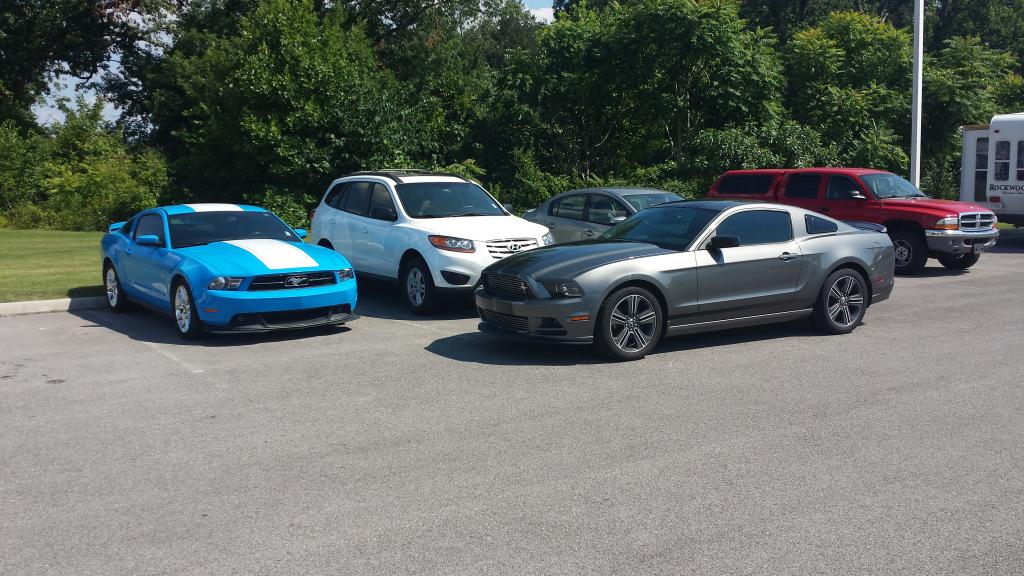

Actually the 275/40 19 IMO do the opposite of the 4X4 look by filling in the wheel wells.
My V6 Performance Package with the stock height and 275/40 19 Continental DW's

I'm going to do exactly this. I wish I could go lower than my Steeda springs, but I have a super stiff driveway. The 275/40s will allow me to fill up that gap with tire and effectively make it look lower with less wheel well gap.

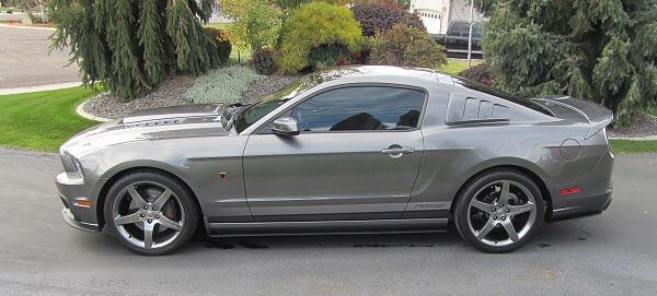

I have 275/35R20's all around, which are basically the same height as the 275/40R19. Just yours would have more rubber and less wheel. Go with the 40's they are the perfect height. The 35's are about an inch shorter. The 40's will really fill the wheel wells nice and you can still lower if you want to. Mine has the Roush suspension which lowers about 1.5 inches off of stock. See my album for pics...

here is a side shot that might give you a better idea of the tire height...

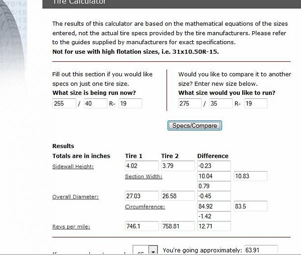

The 275/35/19s are .45" shorter versus 40s that are .63" taller than the stock 255/40s..
The 35s are closer!
They're also favoring the dimensions that would provide better acceleration in most circumstances.
Attached Thumbnails Who is running 275/35/19?-tire-sizr-255-40-vs-275-35.jpg

The 275/40s are about the same height as the 245/45 and 235/55 that are stock too. Only the 255/40s are shorter. Everything else is taller. I'd like to take away some of my 3.73s. They're a bit much for a dd.
