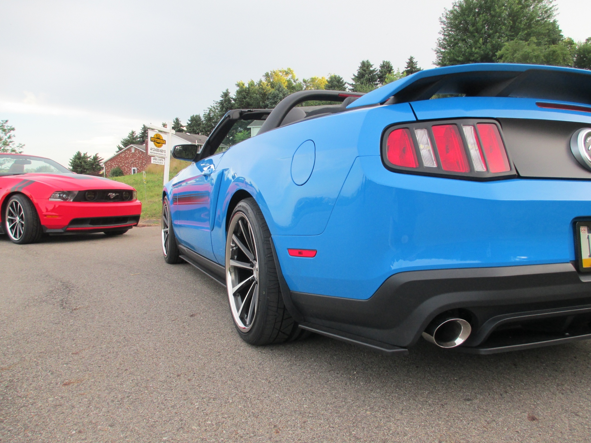

20 X 9 - 32 offset, 255/35/20 front
20 X 10.5 - 42 offset, 285/30/20 back
Eibach Pro-Kit 1" front - 1.5" back drop with Bilstein shocks & struts.
No problems so far......
