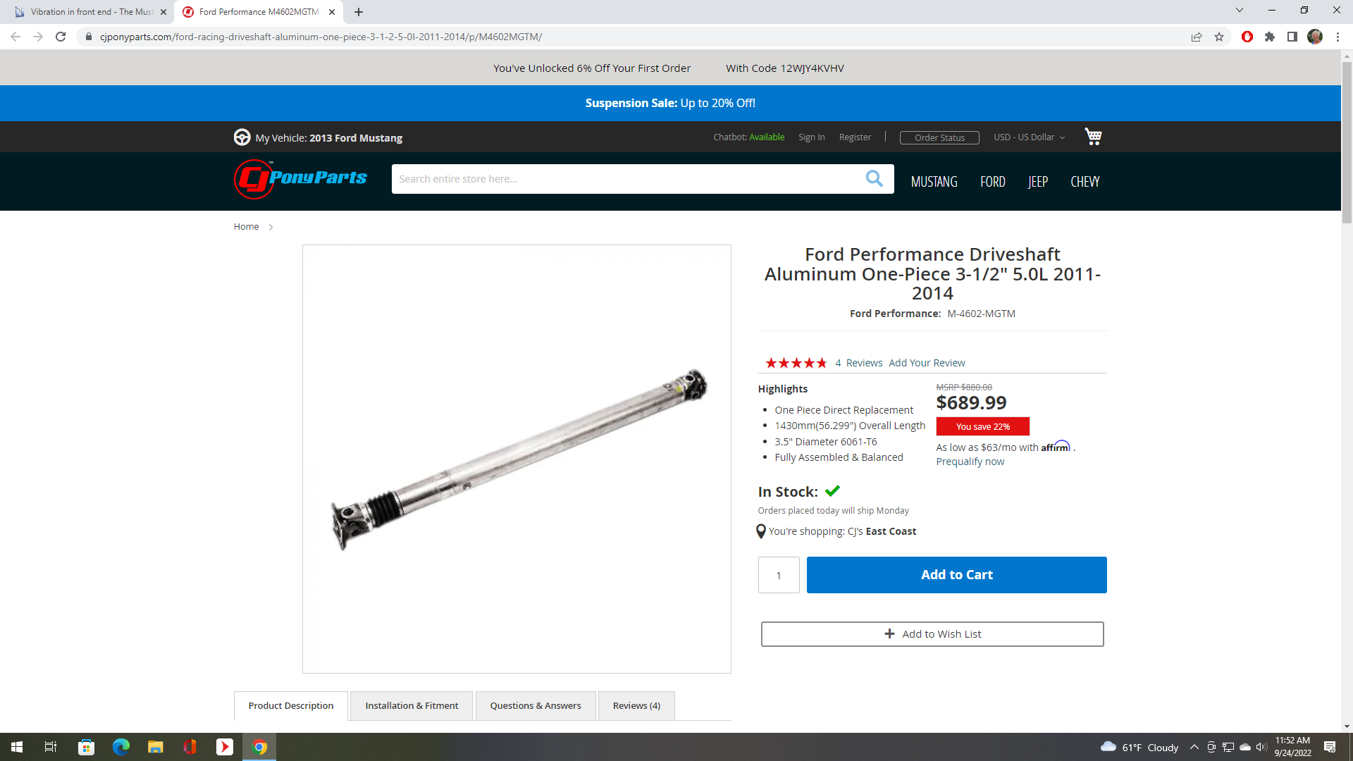

Well, I thought I'd follow up.
Big O checked the entire front end and everything was tight so the consensus was bad struts. They asked what struts had been put it. I'd had the the entire car gone through and all parts subject to wear replaced (brakes, bushings, shocks and struts, etc) at the beginning of the pandemic or 35K miles ago. Took it back to the independent shop that I'd had the work done and they asked to do their own evaluation. Wonders of modern science, the owner had an app wherein you enter the car in question, take it for a test drive, and it locates and evaluates aspects that are out of the norm. In this case it detected the vibration was localized to the drive train (drive shaft, u-joints/c-v joints, etc). Inspection showed that there was wear at both ends of the drive train and (I'll blow the description but) a center support for the driveshaft. Good news it was found before there was damage to the tranny (6 speed auto) and rear end. Bad news is the drive shaft is produced to order with none kept in stock. It will be in between 1 and 3 weeks from now. So I've got a garage queen for the next several weeks.
(In case you're wondering, KBB is $13K (+/-) and a new GT 5.0 is over $44K in this area with the closest being 100 miles away. Plus no one is bargaining. Going to keep my eyes on the 2024 both for hoping the production situation solves itself by then and also hoping there isn't another big ticket repair in the meantime. At some point its cheaper to get a new one than to sink money in an old one.)

Thanks for that. I told the owner of the shop that I wanted to keep it as close to stock as possible. After checking CJ's and American Muscle I also notice a wide variety of prices what with material (aluminum/carbon fiber etc) and shipping costs. At the end of it all the prices are fairly close unless you splurge for the CF ones. Will keep everyone posted.

Final update: Today I finally got my Mustang back home and with all (known) issues dealt with. After waiting 4+ weeks for Ford to spit up a replacement driveshaft, I told the garage to see if a used one could be sourced. They got one out of Texas I'm told. I kind of hate going that route but there were.....considerations. #1 it existed and could be sent to me rather than waiting on inventory shortfalls and promises. #2 My car now has 140K miles on it and the sourced driveshaft has 59K before I got it so its likely that I'll completely use up this Mustang before the driveshaft goes bad if ever. #3 we now had a driveshaft in hand for $450 as opposed to the promise of one from Ford for north of $1000. As a prophylactic the shop did work on the tranny's output shaft transmission bearing. On top of all that, and without asking, the owner went through the car (he had done a major refresh of all the components at the start of the pandemic) and tightened/lubricated a number of suspension points so that now it doesn't "clunk" going over speed bumps. Its all good right now.
