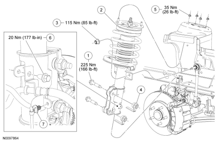

I'm planning on installing a front strut tower brace this weekend on my 2010. It utilizes 2 of the 4 strut mount tower bolts but I'm not sure what these need to be torqued to? Does anyone know what this would be? Thanks.

There you go.

Perfect! Thank you!
