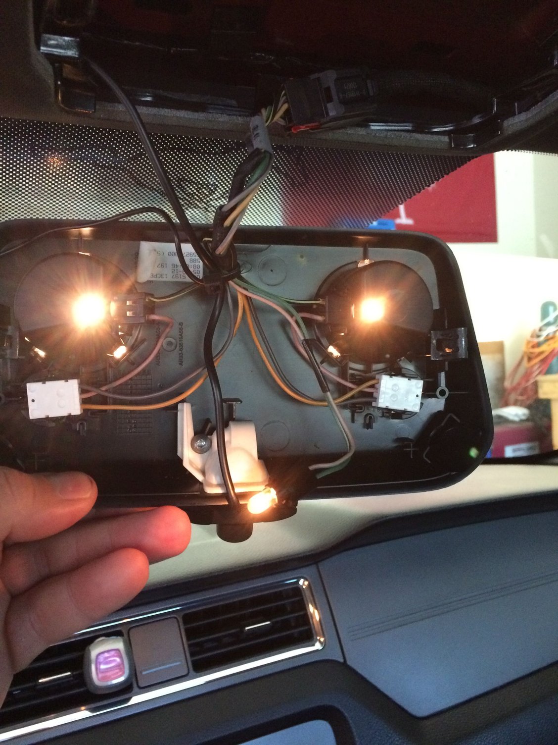

2013 mustang
Girlfriend has a 2013 mustang GT. I was replacing the map lights with LEDs and saw this 3rd light bulb just hanging out in the map light housing not plugged into anything. So I pulled the bulb out. Well then the airbag light came on. I put the bulb back in and airbag light went off. The housing that holds the map lights are the only roof mounted interior lights. No dome light for the rear seats or anything. What the heck is the deal with the light and the airbag? Like I said you can't see it unless you pop off the housing and there's nothing to insert the bulb into for it to illuminate (seat belt light, door ajar, so on and so on). It just hangs out in the housing loose. Light comes on when you turn the key on for about 15 secs and that's it. I know there's a recall for the airbag and I called the dealer today and ford still doesn't have a fix for it yet. Thanks.
