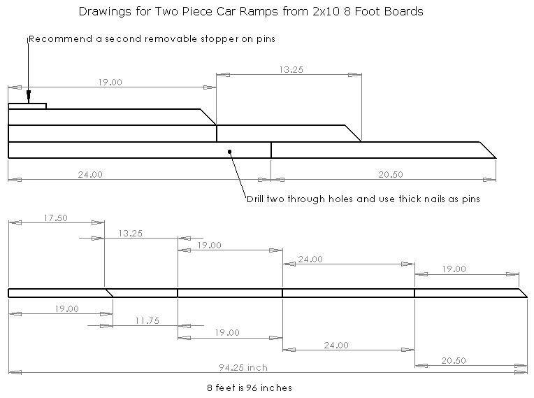

I looked into ramps too. I don't trust plastic ramps like Rhino, and race ramps and low profile metal ramps are way too expensive. So I will just build some ramps out of boards. Solid wood certainly won't collapse and only about $50 in lumber and hardware and an hour of my time. I'm checking the angles but I am will probably copy the dimensions of the RR 56 2 piece.

Here are some nice plans for wood ramps.

Those look simple enough and no chance they could collapse if sufficiently pinned/screwed together.

I agree one should use Jack stands for additional safety. However the wood ramps which are 2x10 planks which lay flat and I would think you could put as much or more on them as a Rino Ramp. I did look at the Rino Ramp reviews and there were failures. I realize one should take reviews with a grain of salt but seeing many complaints one should wonder.

I tried to find any failures with the design I showed by an internet search. There are some with other style wood ramps. Maybe I didn't look deep enough. There are plenty of ramp failures of ramps made of other materials.

A single tire holds up your vehicle with 30-35psi in your tire (with a contact patch of 20-30 in^2). Douglass Fir (common lumber wood) has a compression strength (perpendicular to the grain) of 700-800psi meaning it is about 20-30x stronger than necessary to hold up your vehicle when, for example, a 2x12 is laid flat on the ground. An average contact patch for a tire is about 25in^2 so your tire holds up ~875lb. That same contact patch, on a block of fir, could hold 17,500-20,000lb.
That said, redundancy, like you say, is the best policy.
