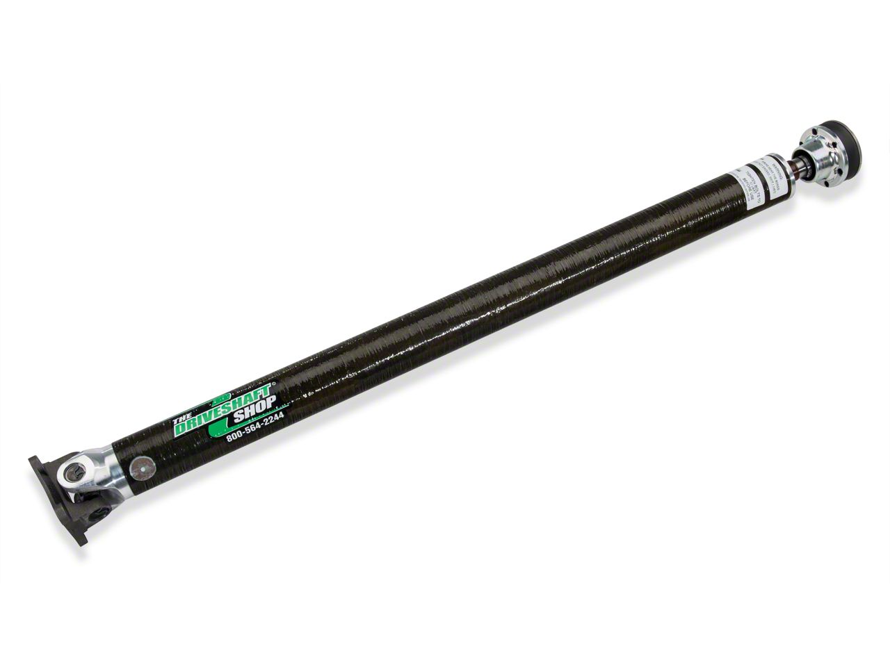

I did a search and this came up as an OE Mustang Driveshaft with carrier bearing and an aftermarket one peace Aluminum..
Go Carbon Fiber...
Go Carbon Fiber...
You still have to pay attention to the pinion angle when lowering regardless of 1 or 2 piece.
