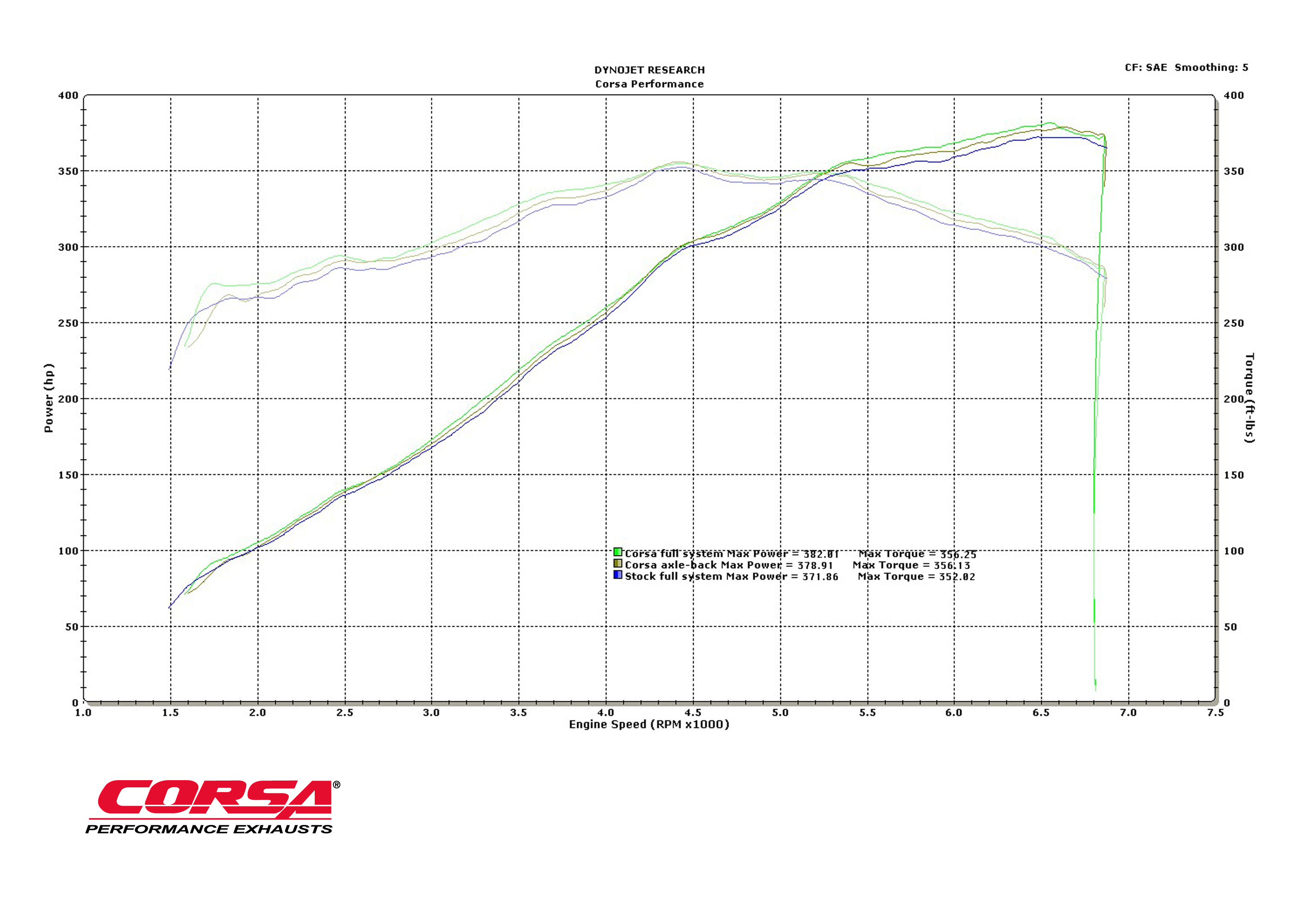

I will have the dyno sheet tomorrow. They said it added 10 HP, 382 at the wheels.

Here are the dyno results:

That's an interesting dyno.
The fact the axle back made over 7 rwhp and 4 rwtq on it's own is pretty decent.
The full system only added about 3 rwhp more and no peak tq more is surprising. However I clearly see that the full system made more power in more places even though the peak numbers weren't that much more.
thanks for sharing
