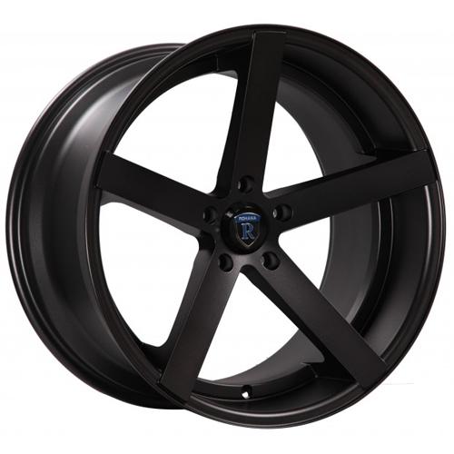

So I finally bit the bullet and bought the wheels I wanted. I got the Rohana RC22 in a staggered setup: 20x9 25mm Offset for the front and 20x10 40mm Offset for the rear. They will be Matte Black Finished, which I hope will look killer with my DIB Paint...
Going with 255/35 (Front) and 285/30 (Rear)...probably Nitto 555.
The Stang is getting dropped with Eibach Sportlines this week, so the stance will be pretty nice with the 20" wheels. Let me know what guys think!!

I think they'll look pretty sick. Are you going to be doing springs and wheel instal all at once?

I'm not a fan of 20's but you will like the car lowered. Congrats

Love the choice on springs and having seen much for these wheels on mustangs yet. I can't wait to see it all together. Keep us posted!

Exactly!! They aren't cheap (almost $400 a pop), but I've always been a fan of the five-stars on our cars. Just feel like that's what should be on a mustang! Different strokes for different folks, right!!

Looks great! As far as what "next"...you'll need an adjustable panhard bar (get BMR) to center your axle/rear end. With those 20's/285 combo, you'll definitely be off to one side.
As for your actual wheel/specs, sounds the same as mine! 40mm offset is perfect with a 20x10. 285's should tuck in just fine. Pics when done please! Congrats again.

Wow, can't wait to see them on the car. I think black wheels with DIB looks really good.

I think it looks good. Those were on my list of wheels if I ever wanted to change out my forgestars.
