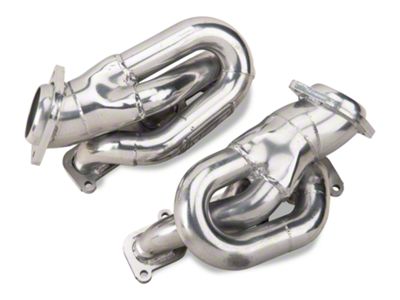

Any reason you went with the shorty pipes over the long tubes? I hear you get more performance out of the LTs

The sound with LTs is changed alot. It is alot raspier and sounds awful in my opinion. The difference between them I only like 5 hp

I believe the shorty headers can see similar peak power gains but long tunes tend to result in gains thru a wider RPM range... And I would think the LT's would change the sound a lot too, too bad they don't make the V6 sound good

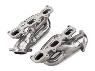

Just FYI...
One thing you state in your commentary on the video is that those headers are "tuned length", this isn't the case. Tuned length means that all tubes are the same length and optimized for scavenging, that one tube on those headers that wraps around the outside is obviously much longer than the other two.

AM says Tuned Length
http://www.americanmuscle.com/bbk-sh...6-ceramic.html

Originally Posted by Ltngdrvr
Just FYI...
What's the firing order of the V6? Factoring in the exhaust pulses based on firing order could be just as 'tuned' as equal length tubes, right? I'm seeing #1 (LF, facing engine) and #6 (RR) looking of the similar length, #2 & #4 similar, #3 & #5 similar.
Tuned Length Design. BBK Shorty "Tuned Length" Headers out perform both the stock factory manifolds and regular shorty headers. Tuned Length Headers have a unique extended tubular design that allows for unrestricted exhaust flow to increase horsepower and torque. Perfect for street and strip.
