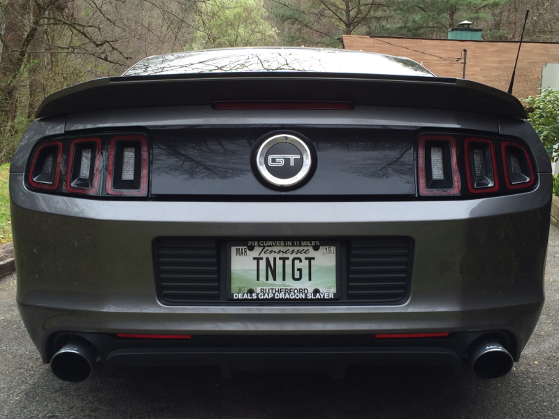

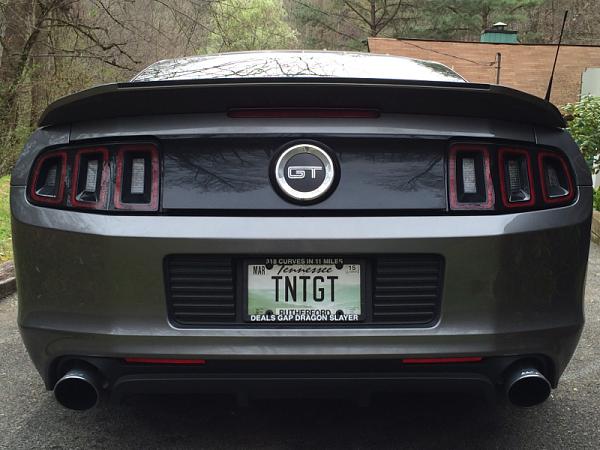

The kit scottv and I installed has the P springs in it. Mine without any thing other then bolting up was 1.2-1.4 deg camber. Stock specs is .7 +/-.75 so still in spec. Yours might be about 1.5-1.7 you have a 1/2 further drop then I do with the K springs. If you take it to the ford dealer, the suspension guys should know to notch the strut to adjust camber. Its in the ford service manual how to do it. You definitely want to get the toe checked, to make sure its dead nuts center of specs. You should not need nor should you use the thin camber bolts. 1.2 to 1.3 is where mine is now and it's great for cornering! Tail of the Dragon calls me ! lol.
