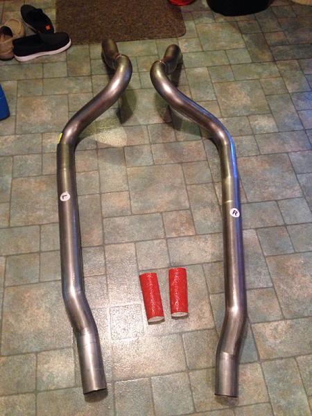

Got my borla ota today anyone know what the two orange things are
Attached Thumbnails Finally found some over the axle GT500 pipes.-image-2713357814.jpg
Those look nice. I've heard those are some kind of shield but I'm not sure where they would go. If you hold the pipes in place, it might be obvious. Are they big enough to go around the outside of the pipes?
I don't think most people use them from what I have read. You might call Borla and see what they say.

Those look nice. I've heard those are some kind of shield but I'm not sure where they would go. If you hold the pipes in place, it might be obvious. Are they big enough to go around the outside of the pipes? I don't think most people use them from what I have read. You might call Borla and see what they say. Wayne
They seem like thick metal and good looking welds so I'm sure they will do the trick. The two orange pieces can stretch so I assume they go over the pipes hope to put them on this weekend so I will see if there's an obvious location.

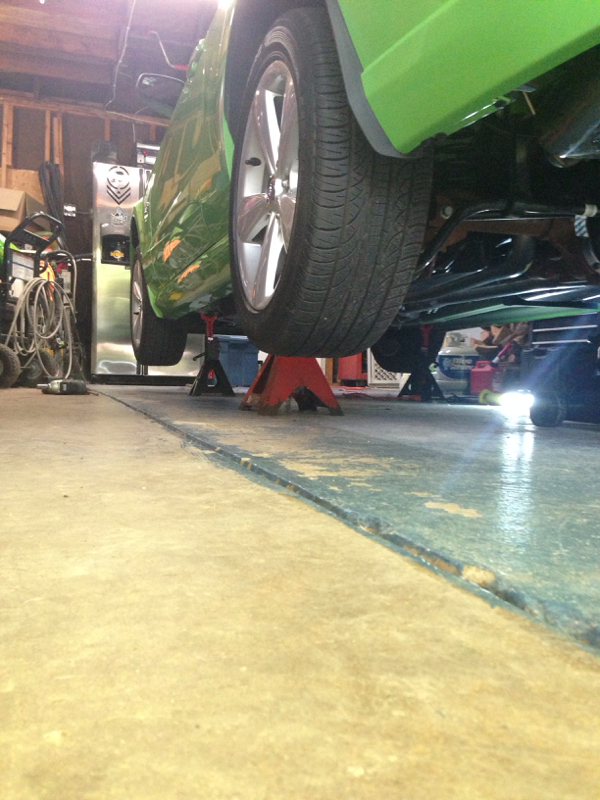

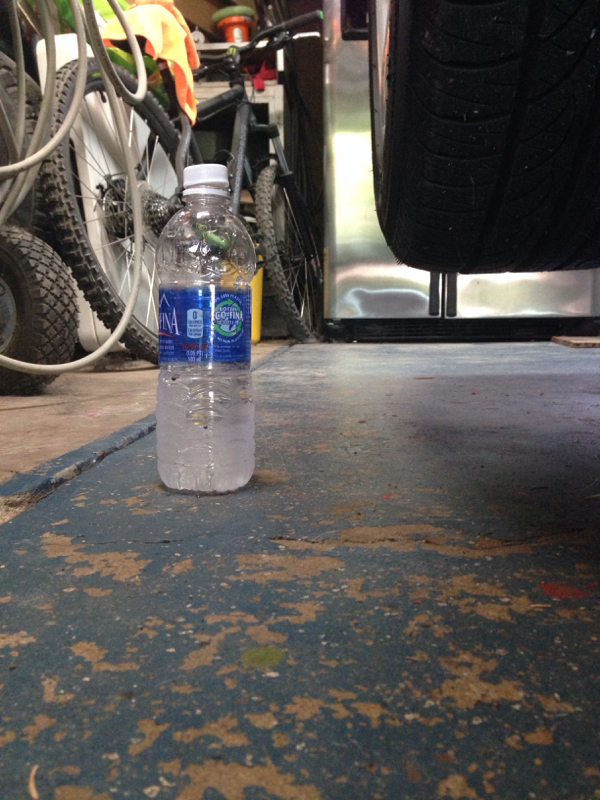

No I didn't have it very high and they pretty much fell out. You have to lower the axle so it's ok to jack it up by the axle but all stands on the frame. Here is a pick of how high it was
Attached Thumbnails Finally found some over the axle GT500 pipes.-image-1566538822.jpg   Finally found some over the axle GT500 pipes.-image-3474993068.jpg
