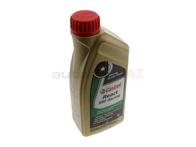

Lol, I have the same conversation with my savings account annually. My wife is cool with car parts budgets, but I have to fight my save every penny alter ego. But after a few we generally come to an agreement on allocation to the hobby.
Motul RBF 600 is great and not too terribly pricey, Castrol SRF is the best. Same wet and dry boiling point and they recommend 2 year flush interval. Extra bonus. About to get it flushed for the next 2 seasons. Check the boiling point, you want something in the 580F + range. Particularly since the clutch and brake fluid reservoir is one and the same on our cars.

.... Check the boiling point, you want something in the 580F + range. Particularly since the clutch and brake fluid reservoir is one and the same on our cars.
Not on ALL our cars
