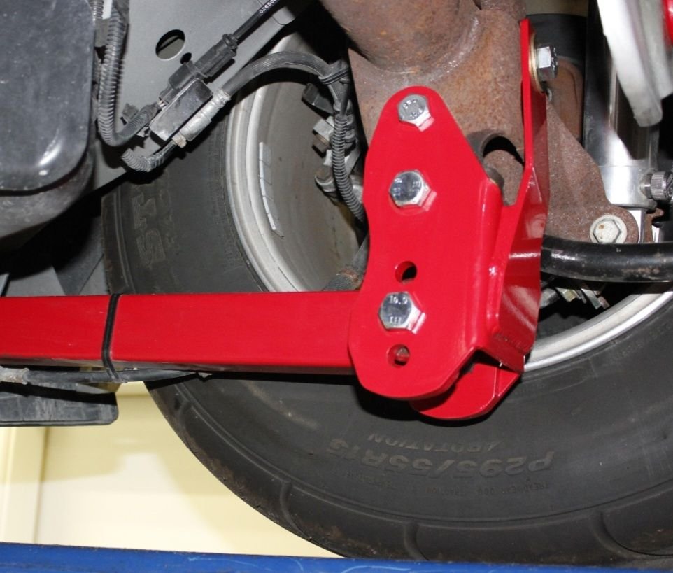

Make sure your relocation brackets are adjusted in the right direction. Be carfull not to twist a an axle tube(weld recommended). I run the Nitro555 G2 and have very good traction. I have 3:55 rear axle. I just jump on it once in while. It took me some time to get the traction down. Street tires have limits.
Thanks for the reply, you have my attention. The BMR LCAs and RLBs only go on one way and they aren't adjustable. All my launches will be at the track. May I ask what you found to make the car hook on the G2s from a dead stop?
Are these the brackets you have? The holes are for changing the angle of the LCR.

I Like It. A Different Position Would Change The Way the Tires Load I Guess!
Interesting!
Looks Like E Brake Cable Was Rubbing Tire and Cable Zip Tied for Clearance??
Yes, those are the same ones I have.
Ford ran the e-brake cable through a hole in the factory control arms. It always rubs a grove in the cable housing. I see you're running 295x55r15s. Do you have the adjustable UCA and 3 hole upper bracket mount?

Thats just an image to find out what kind of RLB you have. Make sure you have your LCR's at a slight downward angle when car is sitting on the ground. I am running a fixed steeda upper mount with heavy bracket set to the stock(middle)hole. My lcr's are gt 500 which come on the Brembo package. My 555 g2's are 265 40 19. I'm lowered on Ford racing P springs with Bilsteins. Most people do trial and error. What works for one may not work well for another.

There are 3 holes to change the angle of the LCR. If you have them set to the wrong hole it will hurt your traction. The hole you use depends on how much you are lowered. The arms need to be slightly downard when the car is sitting on the ground. You probably expect to be able to launch at way to high of RPM for any stock tire. Dumping the clutch without proper control of the right foot will most likely have poor results.

Thanks for all the input. The car has a 6r80 with a Circle D pro 245mm 36-3800 stall vert and is at factory ride height. When you guys say the LCA should be angled slightly down, you must be referring to the rear of the LCA. The RLBs are to change the instant center (IC). The front of the LCA needs to angle up so the IC is somewhere close to the index line. If the front of the LCA is angled down that puts the IC in front of the car or worse below the surface of the track.

Angle down toward RLB.
