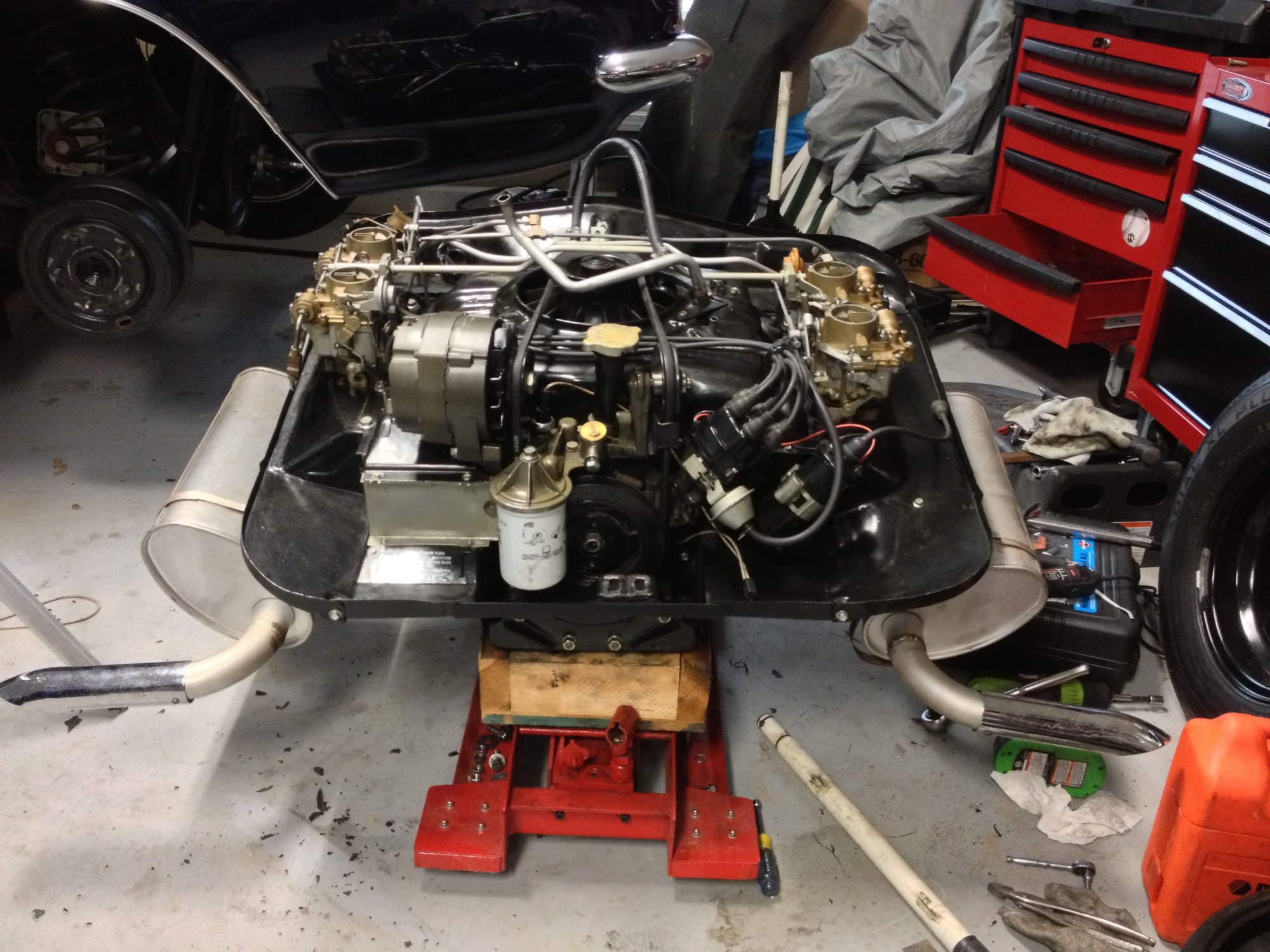

My '65 Corvair has 4 of them....here's the engine out and in the car.
