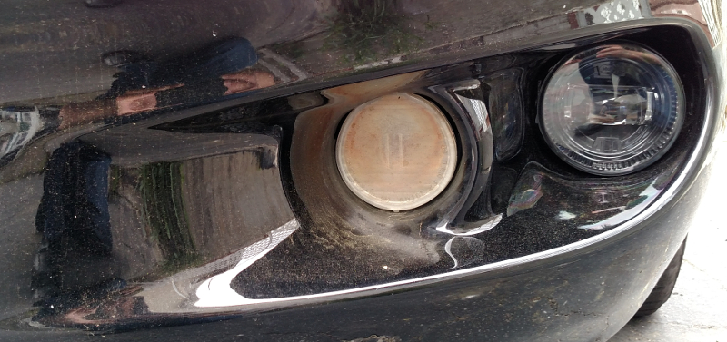

What year Mustang? Which fog light housings are you using? The large "GT/V8" ones in the grill or the small California Special projectors in the lower bumper?
I know you said you removed the upper grill fogs, but I got lost on which fogs you are currently using and not not satisfied with.
The 2013-2014 Mustang GT same with LED Fog Lights in the grill.
If you are talking about the California Special projectors, try H9 bulbs or a 35watt HID kit.

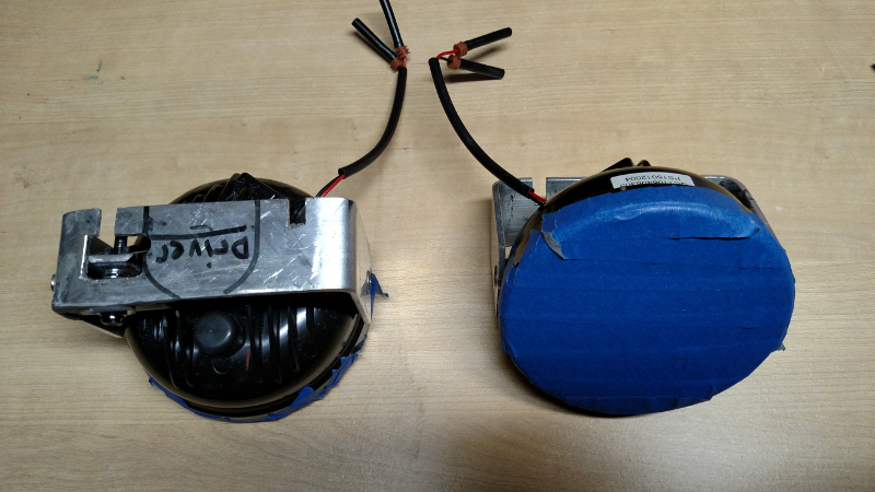

I have bought the F-150 version of the Morimoto LED Fog housings and made a bracket to install them on my Firebird.
http://ls1tech.com/forums/appearance...-housings.html
