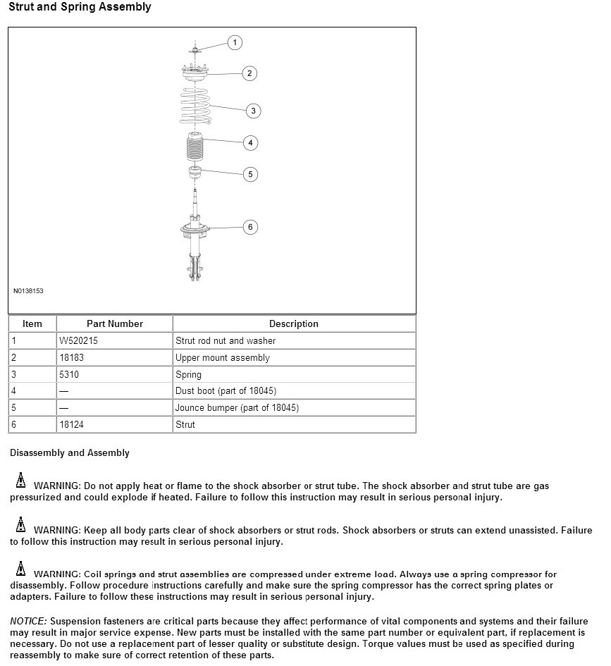

Have you determined where the bearings came from?
Attached Thumbnails 2014 Broken Strut..  Self inflicted, Please help *Pics*-2014-mustang-front-strut-assembly-1.jpg   2014 Broken Strut..  Self inflicted, Please help *Pics*-2014-mustang-front-strut-assembly-2.jpg   2014 Broken Strut..  Self inflicted, Please help *Pics*-front-strut-torque-specs.jpg

You just need the upper strut mount, notorious for failing and falling apart when removing them. 1 time use item in a lot of cases.

*might* have just cocked the spring enough to pull the mount down, but these cars had upper strut bearing issues so often early on, think its just a lightly designed part...on the other side be certain the top hooks arent dragging on the support, hope for the best...
only thing I see wrong is what I dont see: jackstands... dont want to pick on anyone, assume they are just out of the shot- but always suggest secure blocking... back in highschool, I had a jack blow a piston just as I was crawling out from under my 69 camaro to retrieve a jackstand- the bumper brushed my hair as I had pulled to roll the creeper out- wasnt my day to die, but remember it vividly... this stuff happens. it was a small floorjack I'd just had for a couple days (looked a lot like the one pictured) I tore it apart to see what happened- the piston in mine was a single rubber piece that just popped over the rod, sat against a steel seat on the rod- a chunk just sheared off one side of the rubber piston and it dropped like a rock- it musta been marginal, but as I pulled the stands, slid them out then pulled on the bumper to rollout the creeper, that little extra weight was enough to pop it...literally knocked the ballcap off my head. 1 second earlier I wouldnt have known, but my parents woulda seen a horrific mess
anyways, hopefully your other side goes easier, and the strut bearing is a local off the shelf thing, no biggie

The factory strut mounts can be a pain when removing them for the first time. They tend to spit out these small bearings when the springs aren't compressed evenly enough for removal. Even with a evenly compressed spring, they'll sometimes still spit out a few ball bearings. Don't beat yourself up about it! You can always re-grease and install the bearings back into the strut mounts.

see what you do here is............
continue to remove the springs, i.e. remove nut.
pick up the bearings and put them back in the upper mount.
install new springs. install upper mount, reinstall nut. you did nothing wrong, this happens when taking apart the assembly.
profit.
this is expected, nothing is wrong,
