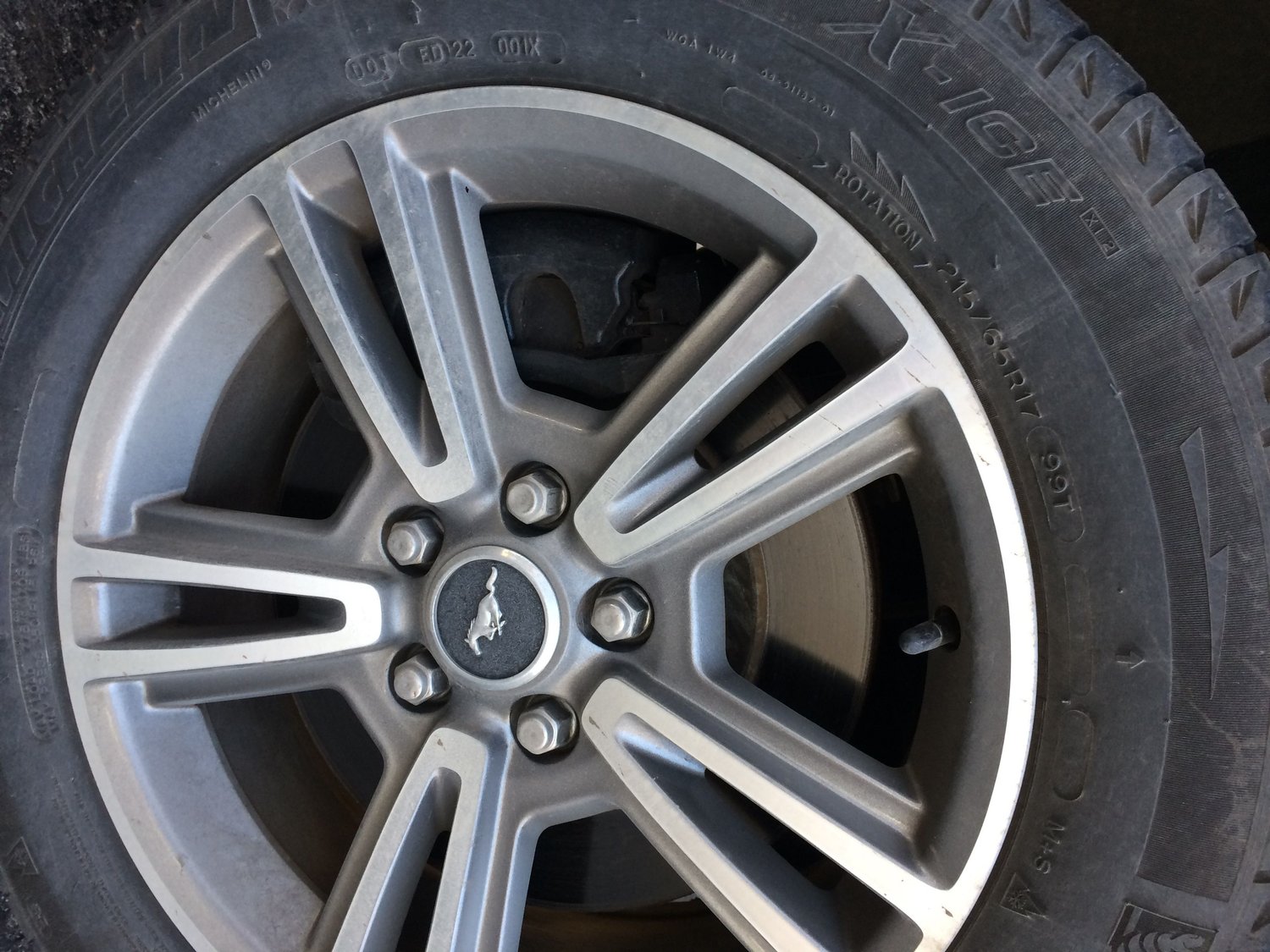

Some 17's rims will fit on the basic GT brake on your 2013. I had an OEM 17x7 ET40 rims fit on my 2014 GT basic for the winter. All I did was grind some of the aluminum material off from the front brake calipers...maybe between 1/32" to 1/8". It didn't take long. A friend of mine has a 2013 GT and it didn't need any grinder on one of the caliper. It depends on how the brake calipers were made. So you might be okay or may need to grind some material off the caliper.
