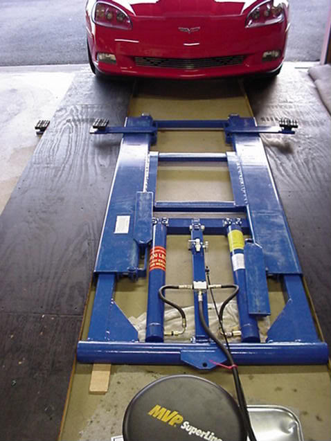

I could use some help I have this scissor lift.

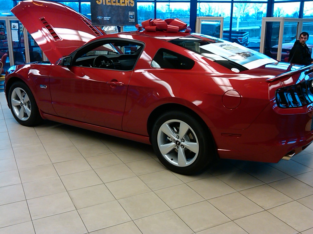

There are no pinch points on the car to lift or place lifting pads. My 2013 Mustang Gt has square lifting holes and the only thing that can be placed in the lifting holes is the jack that came with the car. I've searched a lot and found lifting pucks or adapters for pinch point types but again I have square holes and I would like to lift the stang from the outside edges. Anybody got any ideas????? NEW BABY below

There should be two areas that have openings just inside the rocker stripe about 6"-12" after the front wheel and before the back wheel that will allow a jacking pad or puck to fit on the pinch weld.
True Forged makes a very nice billet pad that works on the 13 Shelbys. I assume the GT is the same.
Look at this thread on Team Shelby for pictures.
http://www.teamshelby.com/forums/ind...an-racing-inc/

They do not touch the plastic rockers. There is a small opening where the pad fits directly on metal.
Buy 4 hockey pucks and cut them to size with a slot and the same result can be achieved.

Don't wanna jack it. I have a scissor lift I need 4 - 1 for each corner. Looks like I'm going to have to make em. A lot cheaper than $200 plus bucks.
I'll figure something out and let you all know.
