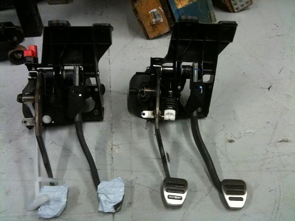

Lethal Performance (GT500 Left / 5.0 OEM on Right): Photo by BoostAddict

As many of you know I have had issues with the clutch pedal sticking to the floor at anything over 6500 rpm. It would actually suck it to the floor when you got within an 1" and not return until 6100 rpm. Its caused by the design of the clutch rebound spring.
Lethal Performance (Week of 4/12 build) had the same problem but not until they turned up the factory rpm limit and it became more pronounced with an aftermarket clutch,. The Pedal Box Assembly on the top right is from the Lethal 2011 GT 5.0 and the large vertical rebound spring was binding and reversing force when it went past center. I believe is was designed this way on purpose to lighten clutch effort. The assembly on the top left is from a GT500 and was used to cure their problem.
Week of 4/19 was Volcano Shutdown
On my 2011 GT 5.0 (Week of 4/26 Build) I didnt have the same pedal box assembly. I had what appeared to be a hybrid of the two. I had both clutch rebound springs. The shaft mounted one (like the GT500) and the separate vertical coil spring like Lethal. On mine I simply slid the lower coil spring mount off the pin and removed the large coil spring. Clutch effort rose from around 20 lb to 30-35 lb. No more stuck pedal and lightening fast pedal returns.
Edited to add photo.

Gene, glad to hear things got fixed. Is this a Ford "fix" ? And does that mean that all cars with a build date of 4/26 and prior that are experiencing the same issues with their clutch will get the same fix as yours. Thx for sharing
First some of the clutch parts were hard to get. (Engineering wanted my entire assembly from pedal to flywheel for testing).
Second Fedex lost some of the parts,
Third Engineering sent a hold as they wanted to send a different pedal pedal box assembly than the GT500 (Which likely raises pedal effort) they originally sent.
Fourth the Service Advisor at the Dealer Left.
Fifth they discovered they dont have his Computer Password so all the communication from engineering about my issue is in never-never land.
Sixthth a little Blue Bird in Livonia gave me permission to try my own fix.
Seventh Im in hiding as I really dont want something that isnt broken (anymore) fixed. Im afraid they may put an assembly that has some reverse force just less in my car, the issue may resurface when I turn up the rpm limit. If its made like Lethals it wont be as easy a fix. I will have to buy a GT500 Assembly.
Eighth I really dont wont my car tore apart if its not necessary .
So its an unofficial fix thats unofficially unapproved.

First a definition of Overcentering:
Overcentering is when the diaphragm spring’s fingers get pushed past the normal centerline of the diaphragm spring. When this occurs, centrifugal force acting on the weights and diaphragm spring keeps the fingers of the spring bent down causing the clutch to stay disengaged during high RPM shifts. Overcentering can occur with any diaphragm clutch but centrifugal assisted clutches are especially sensitive to this. If you can feel the pedal get lighter with increasing revs, that is the clutch wanting to overcenter. All diaphragm-type clutches are prone to overcenter to some degree.
The clutch isnt going far enough to actually overcenter but is getting lighter at higher rpm. With the factory clutch pedal rebound springs both in place I can put the car in gear and push the peddle down to 1" off the floor and rev the engine. When the rpm hits 6500+ the pedal will leave my foot and go to the floor. Pop it in neutral and release throttle and the pedal will pop back up at 6100 rpm. If you pull up on the pedal it takes 5-10 lb of force to overcome the spring pressure and pop it off the floor. I suspect tolerances on my car allow the clutch to come closer to over-centering which is why the improved 4/26+ dual spring assembly that came on my car didnt fix the issue on my car.
Lethal Performance has a Video on You Tube showing their OEM Pedal Assembly in a vice and what happens when the pedal is pushed. When the pedal goes so far the coil spring binds in the middle and starts compressing part of the spring which causes the pedal assembly to snap fully depressed. At low rpm the clutch pressure is enough to resist this no matter what. At high rpm near fully disengaged it isnt.
