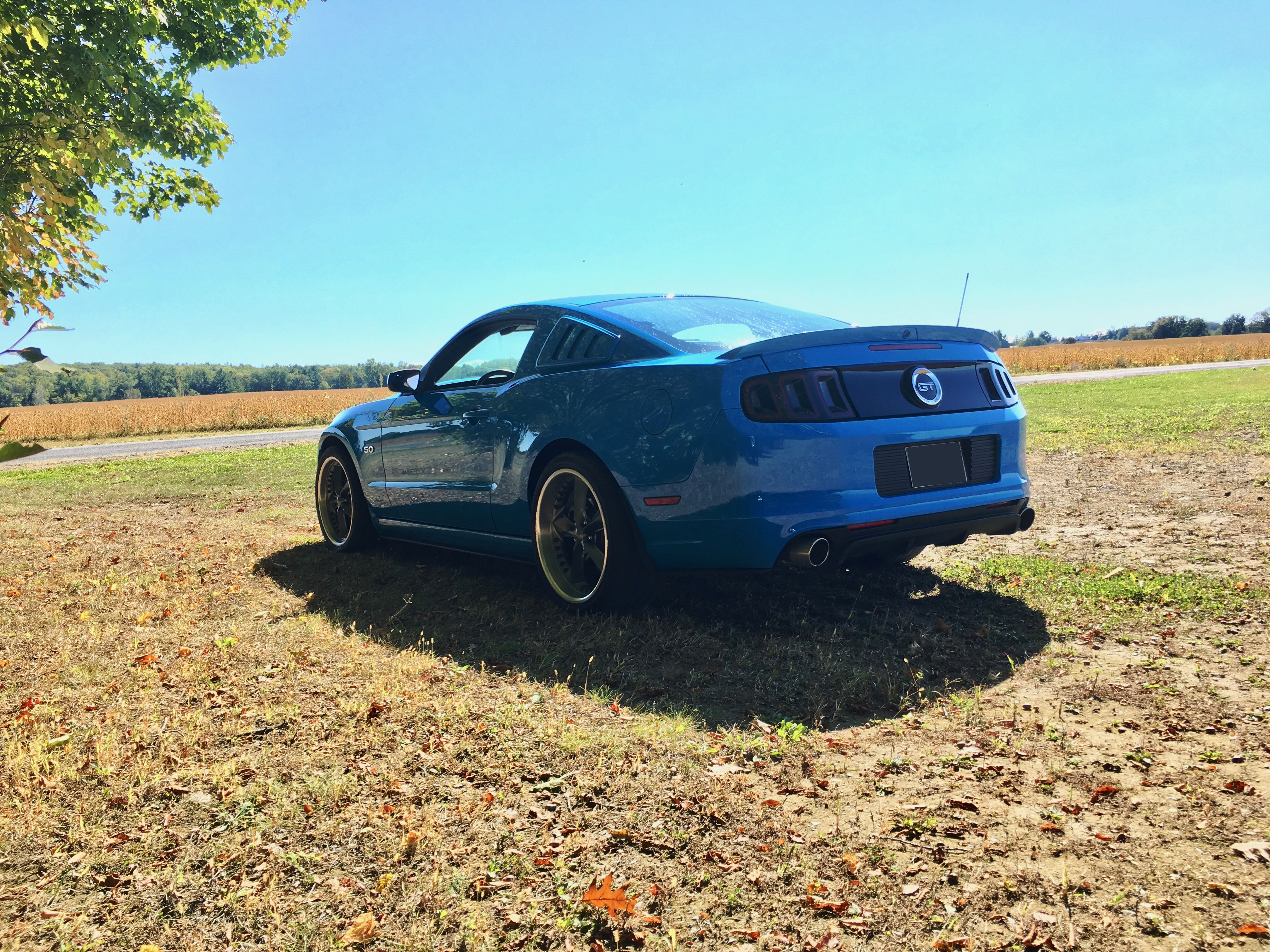

Hey guys, just got these Foose rims from a guy dirt cheap cause he sold his mustang.
So as expected they didnt clear the brembos, I had to use the 1" Eibach spacer and they just barely clear them now. Im very happy with that however I noticed some slight vibration on my steering going 50-60 kmh specifically, on lower or high speed the vibration is not noticeable. Things that has been done are removing those retaining clips that holds the hub, cleaning the disc surface, balancing the tires. I brought the car to another shop and they told me the tires werent balanced properly. So after the 2nd re-balance now the vibration is less but still there when going around 60kmh.
I want to know if this would have a long term effect on my suspension/bearing etc.. the vibration is very slight that I have to let go of the steering and look for it but when I hold the wheel its not noticeable, again would I be fine with this ever so slight vibration in the long run!
For tires I have 255/35/20 MT street comp up front and 275/35/20 Falken Azenis which need to be replaced soon at the back.
Could MT low profile soft compound have anything to do with this?
I love the look of this setup. just wished I could eliminate that vibration completely but I cant think of anything else.
BTW here are some pics
