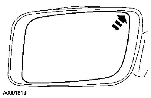

-Push in the upper edge of the mirror glass to the maximum travel. See 1st picture.
-Grasp the bottom of the mirror glass and pull outward.
-Disconnect the electrical connectors and remove the mirror glass. See 2nd picture.

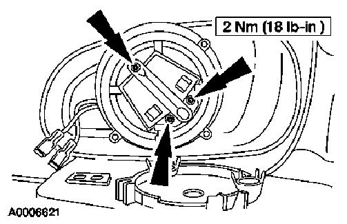

2. Remove the mirror motor screws. See 3rd picture.

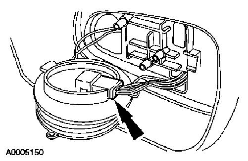

3. Disconnect the electrical connector and remove the mirror motor. See 4th picture.
