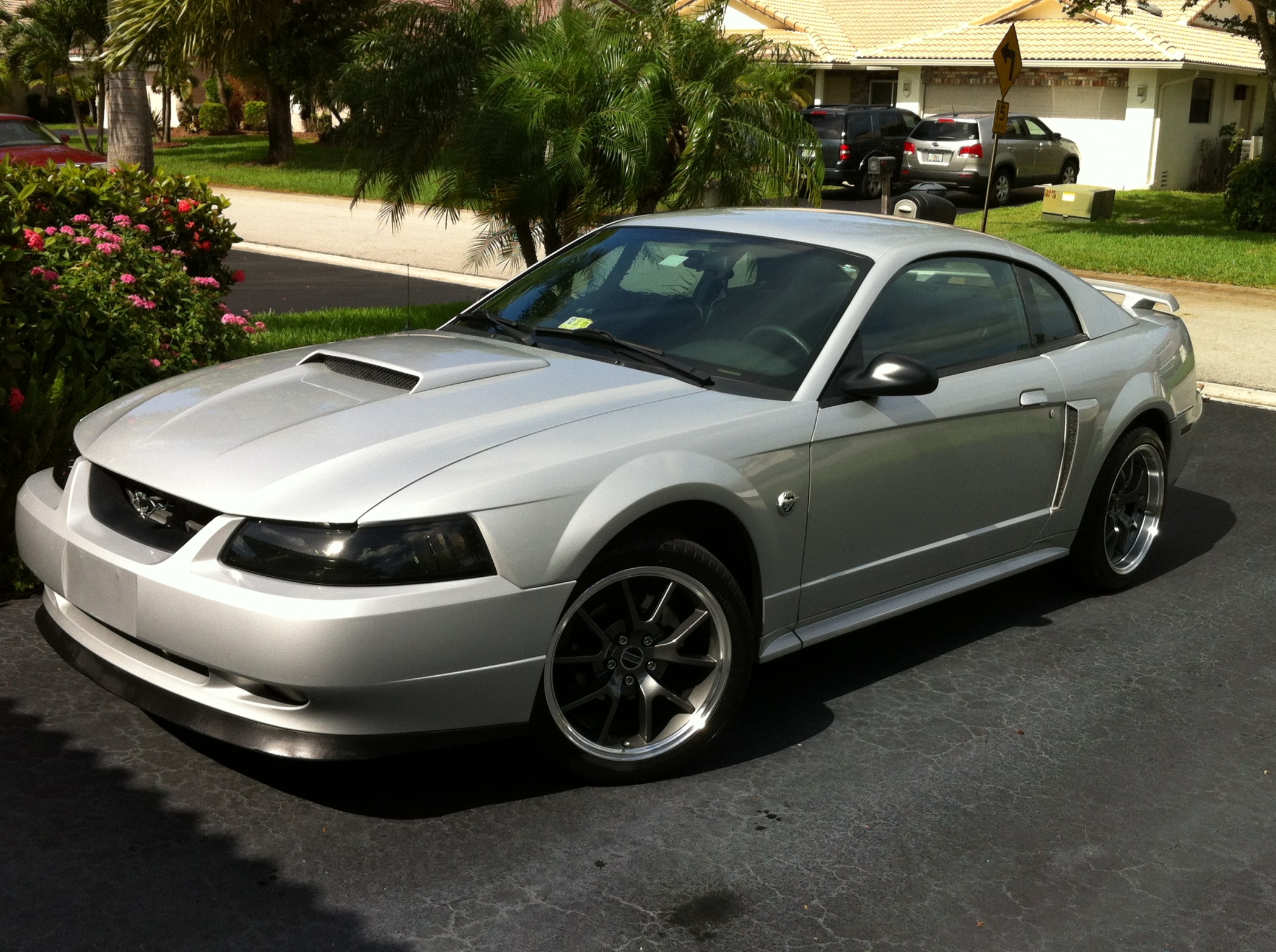

Thought you guys might like to see the wheels
