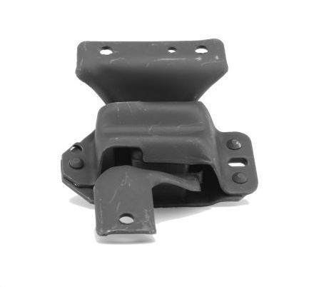

This is the V6 Left mount. Notice the ears, vertically aligned? That's the bracket to the engine. Compare to...

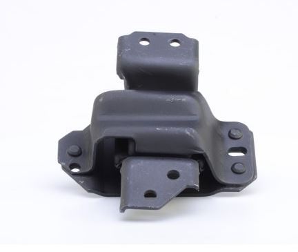

... the V8 Left mount. Wider at the top, narrow and offset to the left at the bottom.
The Rights are similar. The mounting to the engine is the issue, V8 uses *less* mounting holes... odd, that. Anyway, the V8 ones could be made to work, but it'll involve either a plate to make them work, or you'll have to weld the mount brackets with new metal on the lower part of the V8, and fill/drill holes for the upper part, maybe cut some of it off. If one had to make THESE work and couldn't get the V6 ones. So with that knowledge, it's entirely possible that you could modify the aftermarket solid ones for a v8 somewhat 'easily', 'easy' being how skilled you are at metal work or schmoozing/paying someone to figure it out.
