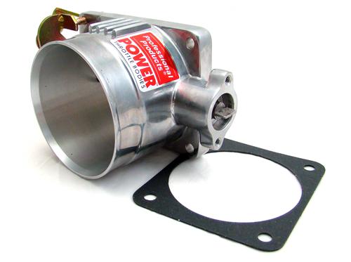

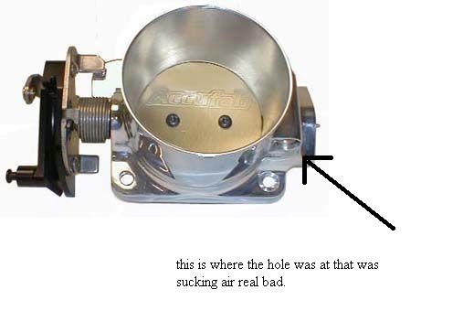

throttle body pic
This is your throttle body pic, I just pasted the same pic and pointed out where my hole on mine was.

No vacuum hoses go there! If its really that much of a concern aftermarket aren't to expensive and oe shouldn't be to hard to get...

Okay I see what you are talking about. It isn't on all TBs, if you look at the pics you can see that not all have this. if you look at the accufab TB it probally has some type of plug in it and no doubt goes to the butterfly blade during construction for setting the blade but it also looks like part of a formed cavity for the TPS also. I have looked at tons of pics and even on TB installs to double check. It really looks like the plug fell out, nothing like a vacuum line goes in it. you need to plug it because yes I can see now how it is sucking in air or change out the TB.
use this link, click on the install link they have a video. The TB looks like yours but you can see that there is no vacuum hose going to it.
http://www.americanmuscle.com/bbk-75...y-96-04gt.html
hope this helps.
