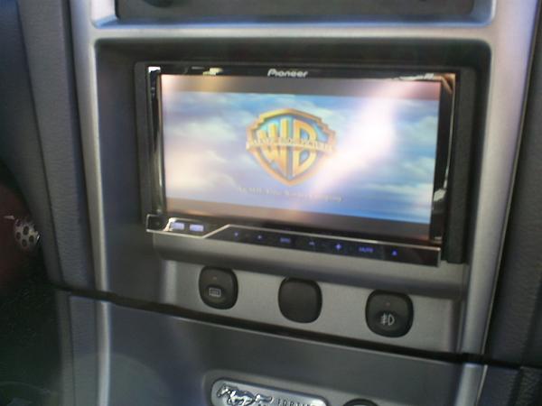

in the later years, can't remember when specifically, Ford changed the stack setup to look like this (I've already taken the trim piece off, sorry) instead of separating the radio and the cd player. If yours is like this, it's quite simple to swap.
Attached Thumbnails 2000 mustang gt nav system-s5031438.jpg   2000 mustang gt nav system-s5031443.jpg

Double dins started in 01. You would need to buy the bezel from a later model, then cut a couple tabs and you'll be good. If you search on Modded Mustangs there is a really good write up.

mine has the separated radio and cd player, so ll i have to do is find that center plastic piece from a newer one?
Old Oct 14, 2012 | 08:06 PM
Yes you need to buy a 01-04 center stack piece. There are tons on mpsautosalvage.com
