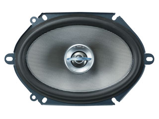

I guess my real question on the front speakers would be, get
A)Multi-Element Speaker

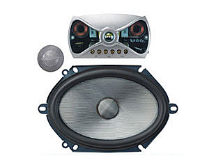

B)Component Set-up like this
Attachment 6205
I am leaning toward the Multi-Element for ease of install, but I am eventually replacing everything, including the HU, and adding amps, etc.
