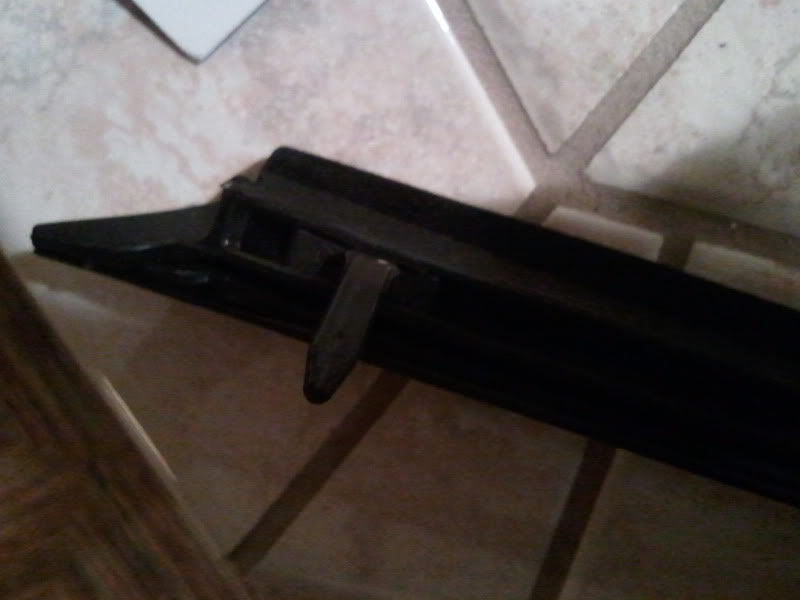

Any ideas how to get the outside channel off? Someone damaged mine.
Picked up a replacement but the front of it has a barb....?
Im guessing maybe the exterior rear view mirror has to come off...??
